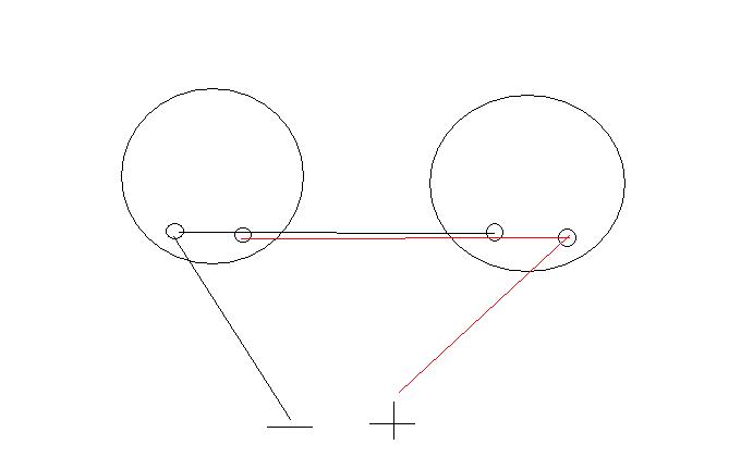

It cant hurt to wire it that way. have one wire come from the positive on the amp go to the positive on one sub. Run one wire from that subs positive to the other subs positive. Run the Negative to the other sub and run a wire from that negative to the other negative on the other sub. That would than be wired in parallel, and would reduce the ohm in half.

Do not wire the subs parallel if your amp is only rated for a 4 ohm load. Two 4 ohm subs wired parallel will be a 2 ohm load therefore putting more of a strain on your amp.
Edit:
Just looked at the specs for your amp and it is a mono amp suited for a 2 ohm load so you will be fine wired parallel.
