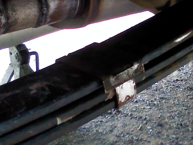

well.... i got instructions from general spring yesterday. so as you guys know theres 2 springs and a 3rd straight one. not sure it you call that a spring or not. so.... i was trying to put the add-a-leaf between the bottom flat one and the 2nd spring because i didnt think i would have to take the factory leaf clip off. so it has to go under the first leaf and above the 2nd leaf which becomes the 3rd leaf now.

5. For this particular vehicle the factory clips will no longer fit so you must remove these clips by either drilling out the rivet or cutting off the rivet head with grinder / sawzall / torch

10. Install the replacement clip by putting on the U shaped part and then the cap on top. Put a clamp or vise grip c clamps on tight and then bend the tabs outwards and hit with a hammer to secure.

3. You could probably get the factory clips to fit but with the gauge you ordered I think it will be easier to just remove them rather than fight with it trying to get the factory clips to go back on because there's not a lot of space in there.
