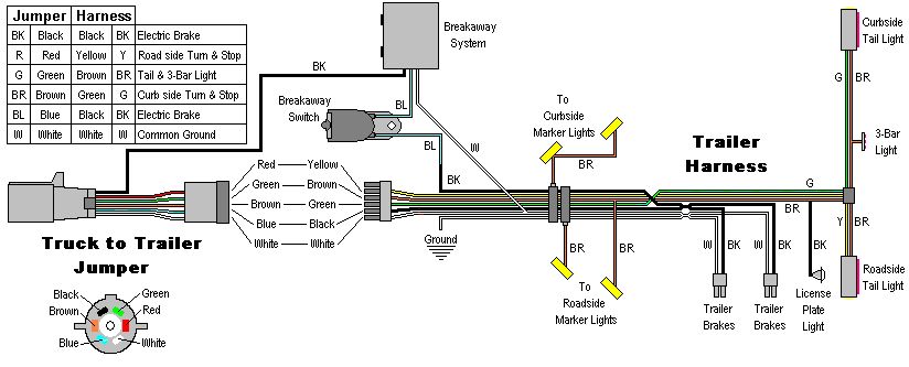

Here are a few diagrams to help.

No worries. I actually tested it by touching the probes of the multimeter to the running lamp and ground prongs of the 7 pin outlet on the back of the truck. No trailer or connector hooked up so I have traced the issue back as far as the truck. Tail lights of the truck were obviously on when I tested. I tested the other circuits (left and right lamp) and they both worked so I know the ground is good.
