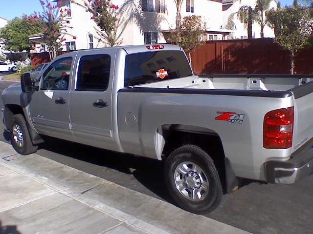

Installation was pretty straight forward on the OEM Molded Splash Guards. The fronts install with no drilling using existing holes where the fender liner bolts to.
The rears do require drilling, which is easy, EXCEPT, (for me) required removing the rear wheels in order to get the right angle for the drill of the three holes that go into the fender lip. Other than that, super easy install!
