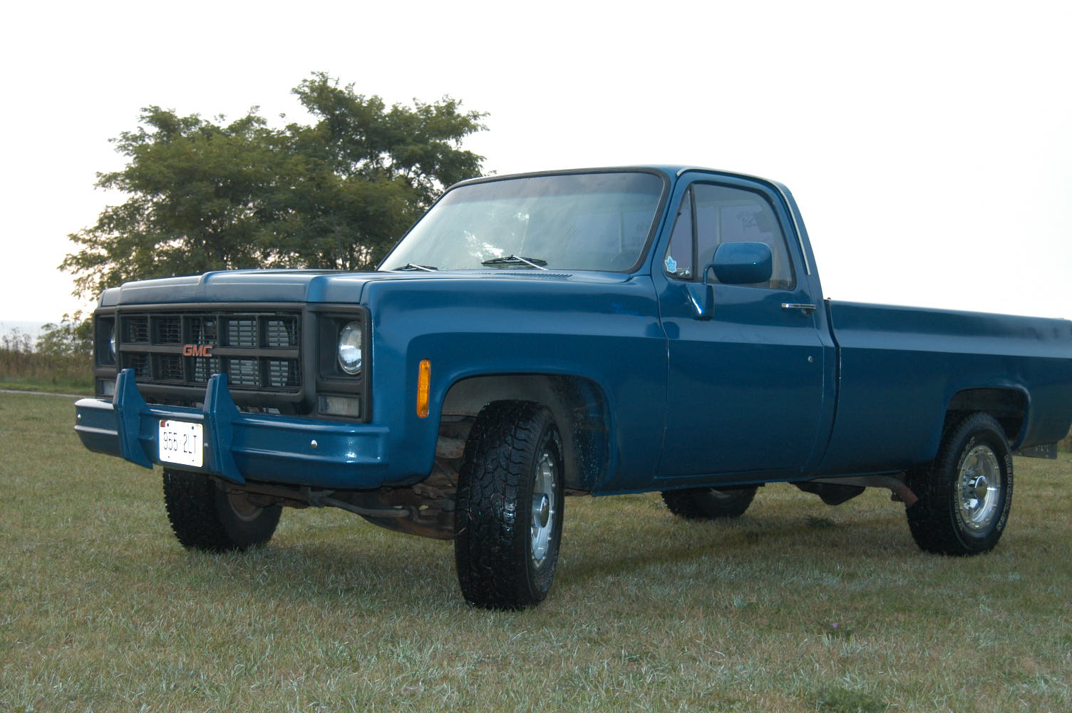

I am restoring my 1980 GMC 25 and wanted to know what Emissions requirements that truck had in 1980
I live in Ontario and don't want a nasty fine for not having the proper emissions on my truck. The sticker that was on the air breather is gone. I know there were some items on that sticker.
