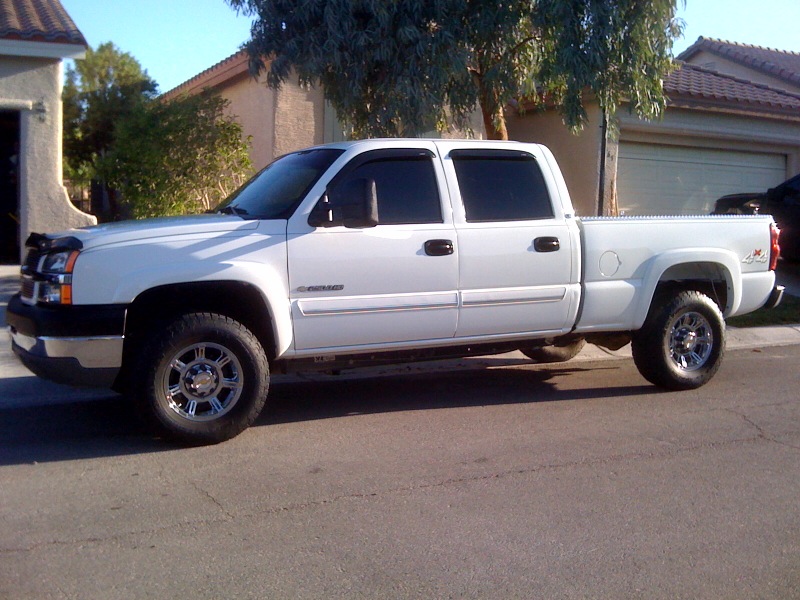

I don't know the backspacing of the H2 wheels, but I've got a set on my '04 2500HD, and they fit just fine. I do know that they are 17x8.5 size. Hope this helps.
Those look good, what size tires are you running?
Your stock wheels are 16x6.5 with a +28 offset, so the backspacing is about 4.8 inches. I'm not sure about the hummer wheels, but I've seen quite a few of them on 2500HD trucks. Just make sure you keep your stock center caps for the hummer wheels.
I got em too but don't know backspacing. When I was researching them, I remember them being the same. I am running 285/70/17 e rated. I added a 2.5 inch level kit and do no have rubbing issues. The center caps even worked. I don't imagine there should be any difference on the GMT800.
Thanks! They are a 285/70R17E, same size GMC Anthony is running.
