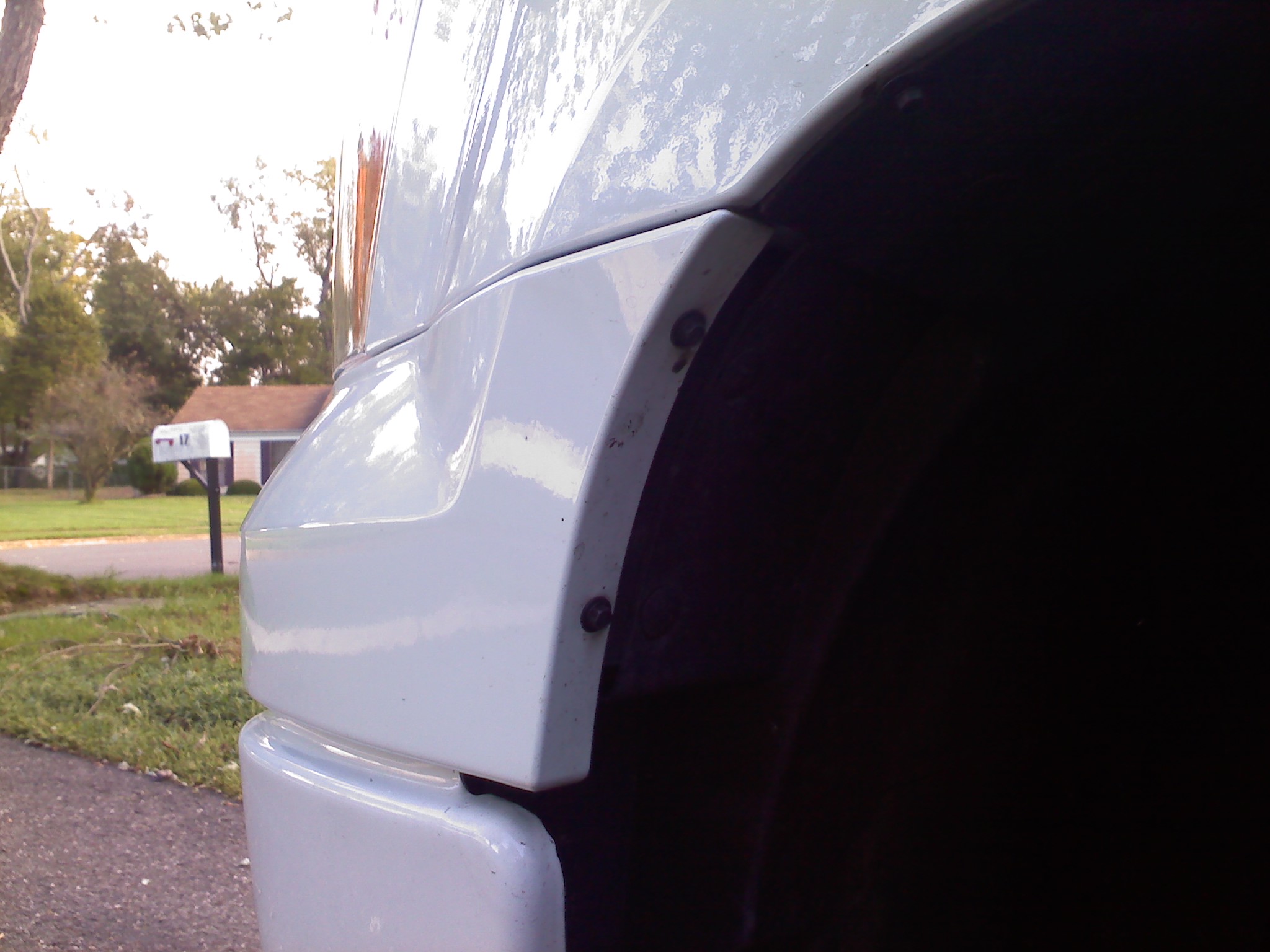

Are they phillips screw or what? i am not seeing them
They are 2 7mm screws just in front of the tire in the lower surround that goes under the headlights. take these out then while holding the surround carefully pull it outwrads while giving it a little wiggle to relese the clips. The 6 metal clips on the grille are the hardest to release, just needle nose pliers on these

How are they different? GM lists the filler panel as 07-11 GMT900 in Mitchell database with the same part number.
uh, duh i tried that. but there is more up under there. thats why i specifically asked about a 2010 cause they are different than a 2009 or older. Thanks montyss, you actually know what you are talking about.
the reason i say they are different is becasue there is more than the obvious two screws in the wheel well holding it on. there are screws inside that go up to hold it on.
Actually they are clips where the fender meets the filler. It's been a while on mine but I believe there was one somewhat hidden screw under there too.
Thank you. Its probably a lot easier when you know what you are looking for especially for a mechanic who has done it more than once!
