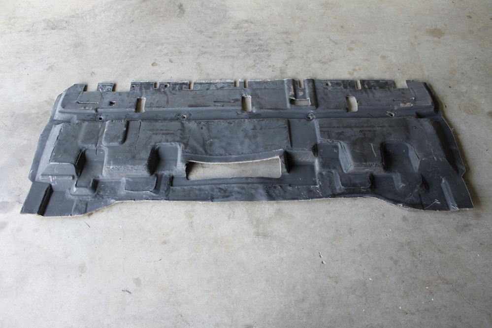

I have done some research and found that they have changed the rear insulation panel from 3/8 inch rubber coated panel on the 07- 10 models and have changed to a non rubber coatred panel in 2011. This panel is thicker, but lets more noise through. I hvae taken my rear seat out and have "Dynamatted" the whole rear and that made no difference. I have covered the vents and it helped out 100% but blew my ears out when I turned the fan all the way up. DO NOT COVER YOUR VENTS.
The vents appear to be the same vents that the GM truck has udes since 1999. Some modifications, due to "U" bodies,ETC. But for the most part all out our treuck from 1999 til 2011 have the same vents. It must be the rear panel. I have bought one from a junk yard and will replace mine this weekend. Ill post the results.
Oh yeah I'll bet that everybody that has the noise had a grey insulation looking mat behind their rear seat. And all of those that do not have any road noise have a Black or dark grey panel.
Vents from 1999 till 2011 are part #15927977
Rear panel from 2007 til 2009 and some 2010's is 20790482 and I do think that GM have replaced these withthe new panel that is in the 2010 and 2011 part #20983473.
Can anybody do some more research and comfirm this with a GM parts guy etc???
