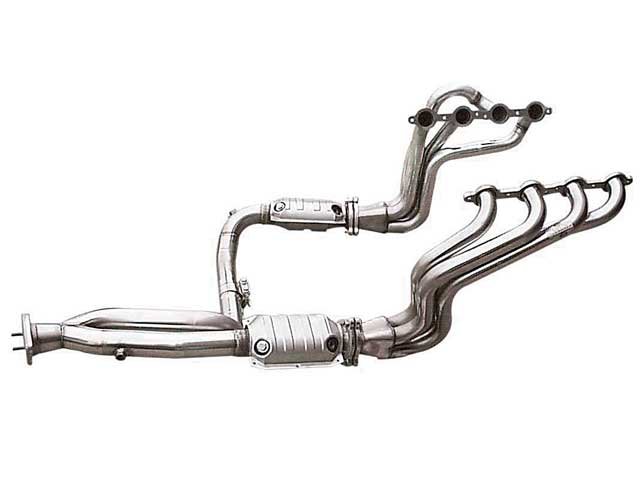

I recently purchased Dynatech supermaxx headers with hi flow cats,Corsa dual exhaust 14199 and a K&N Cold Air Intake next wed it will all be on I'm pumped been waiting over 3 years to do this.
Do you have tune like a black bear, wheatly, etc? If you do you will have to get the rear o2 sensors turned off when you add the headers/high flow cats or you will get a check engine light and it will run rich. I have the same header/cat setup and that is what happened when I put them on mine before I got the tune fixed. You will like the the results. What corsa muffler did you get? I have the touring and it was stock sounding before the headers but after the headers it has a really nice growl when you get on the throttle. If I would have gotten the sport it would have been a little too loud for my taste.

Thanks that good to know ya I will be getting a tune but it will at a local shop I read the Black Bear deal I'd rather just put it on a dyno and get it done will see not sure yet might do the BlackBear.
