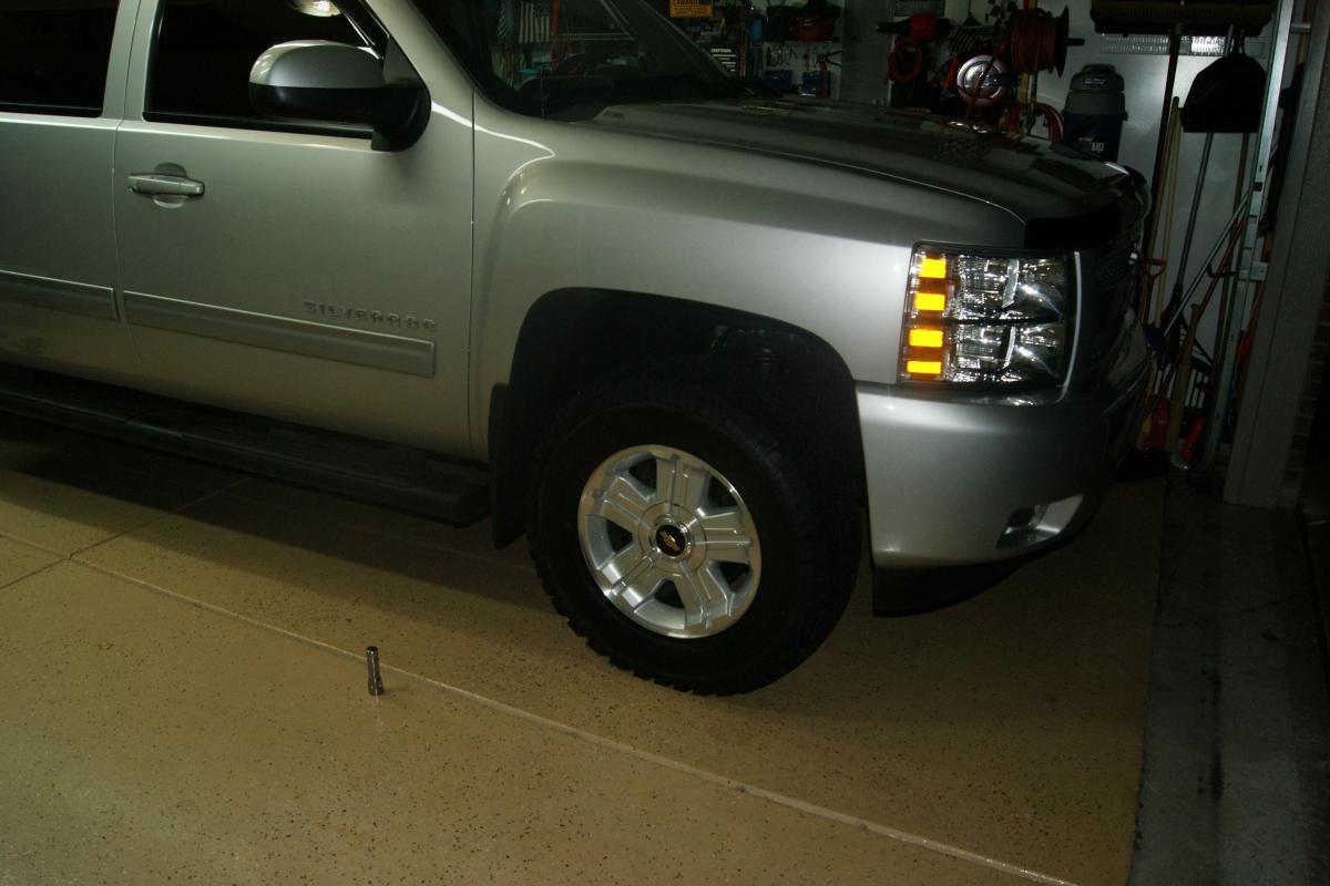

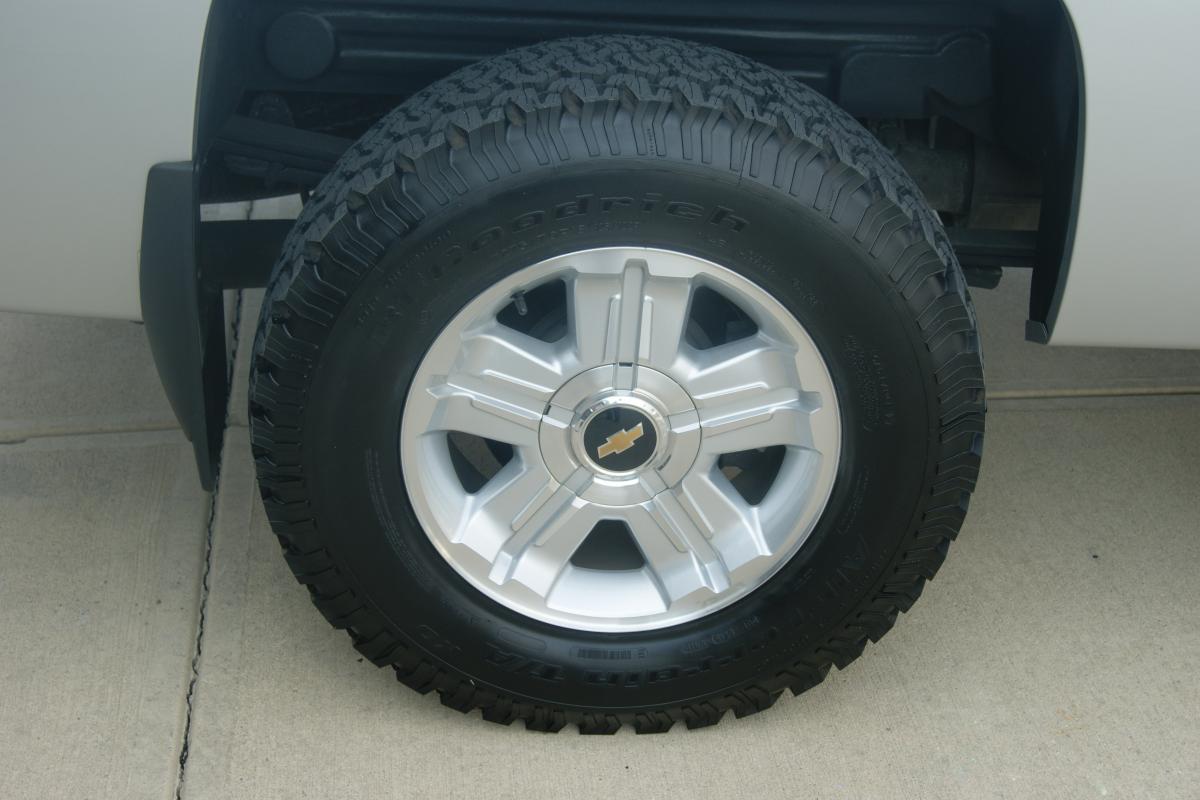

Hi guys the tires look awesome on the silverado. I have a question as well. I have a 2009 ext Cab Z71 Red with a 2 inch front self leveling kit last week. I'm running the bridgestone duelers from stock but I was ordering new tires next week. The stock size is P265 65 R18's and I was going to order LT285 65 R18 in that same BFG All-Terrain. Will it or will it not rub and will it add some ground clearance and look good? Looking forward to your replies. Pics would be killer if anyone has that size tires in a BFG. Thanks. Hitman77
Shouldnt rub as long as you have a front level kit. Also the 275/70's are taller than the 285/65's. No issues with 275's rubbing.

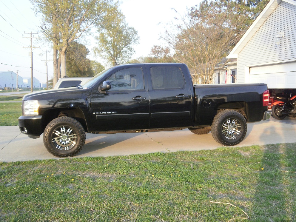

I just got 275/70/18 on my 2012 and they rub only at full lock reverse and that's plastic but it's minnor rubbing (no leveling kit yet), its not like it going to rip the liner out. I live down a wash board dirt road and it almost seems smoother than factory p tires but then again all I have ever run are load E BFG's.
275/70-18s Toyo m/t on Helo 835s (awesome tires but spendy) No rubbing ever, with a 2.5" leveling and 3" block in the rear.
I really miss this truck and the look, sold a year ago
