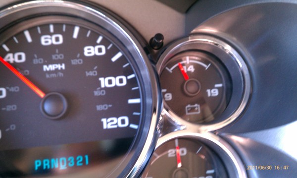

The Bigger Issue I am having for the last 1.5 years is the Volt Meter in the Dash has these weird readings
I will be driving down the road and a normal reading with be over 14 Volts then suddenly the Volt Meter will go way below 14 Volts and the windshield wipers and windows will operate very slowly even at 70 Mph. & 2,100 RPM's
I usually have to stop and shut the truck off & restart it to get the eter to read over 14 again and within a minute or so it'll go right back down below 14 volts and the same scenario will happen all over again

#07-06-03-009B: Information on Voltmeter Gauge Fluctuation Due to Regulated Voltage Control System
Voltmeter Fluctuation Condition
Some customers may comment that the voltmeter is fluctuating between 12 and 14 volts on their full size pickup or utility vehicle. Starting with the 2005 model year, light duty full size pickups and utilities are equipped with a Regulated Voltage Control (RVC) system. This system reduces the targeted output of the generator to 12.6-13.1 volts when in "Fuel Economy Mode" to improve fuel economy. The generator may exit "Fuel Economy Mode" if additional voltage is required. This will cause the voltmeter to fluctuate between 12 and 14 volts as opposed to non-regulated systems that usually maintain a more consistent reading of 14 volts. This fluctuation with the RVC system is normal system operation and NO repairs should be attempted. :uhoh:

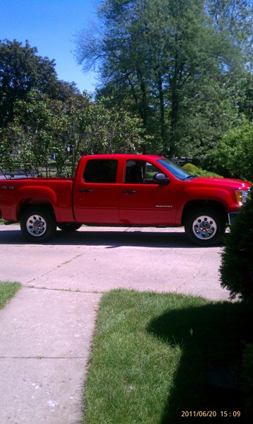

I just Picked up a Brand New 2011 GMC Flex Fuel Sierra 4X4 with the Vortec V8
about 10 days ago
I was backing into a Parking spot at work, and went to put up the windows and they were going slow, I looked at the Volt Meter and there it was again
The Meter was reading about 12 Volts, and I almost crapped myself thinking I had the Same Problem (or so I thought) as I did with the 2008 GMC I just traded in.
