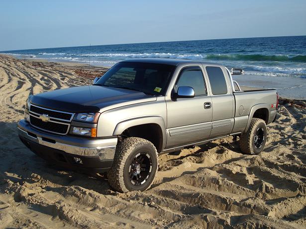

2010LTZ4x4 Posted March 6, 2011 Posted March 6, 2011 I am looking at adding a more aggressive stance to my truck. I want the tires to be about even with the outside of the factory fender flares. I was just wondering what kind of backspacing and offset combo I should be looking into. You'd probably want a 9" to 10" wide rim and a 4.5-3.750 back spacing. The 3.75bs would stick out the most. This is a 10" wide rim and 3.75BS

RaddHazzard Posted March 6, 2011 Posted March 6, 2011 I own moto metals with -12 mm offset. 17x9. Same body as your red truck. They stick out a tad past the fender flares. It looks good, not too much offset.
RaddHazzard Posted March 6, 2011 Posted March 6, 2011 After looking at my truck, the tire sticks out about exactly as far as the fender flare does. These are 285/70/17s.
stlavsa Posted March 6, 2011 Posted March 6, 2011 After looking at my truck, the tire sticks out about exactly as far as the fender flare does. These are 285/70/17s. nice I kinda thought they would stick about about a CM or so past the flares.. I guess they would stick out a good bit if you were running a big tire.. So thats something the OP should consider. If he isnt running a lift i would imagine he will be at 285s or less.
