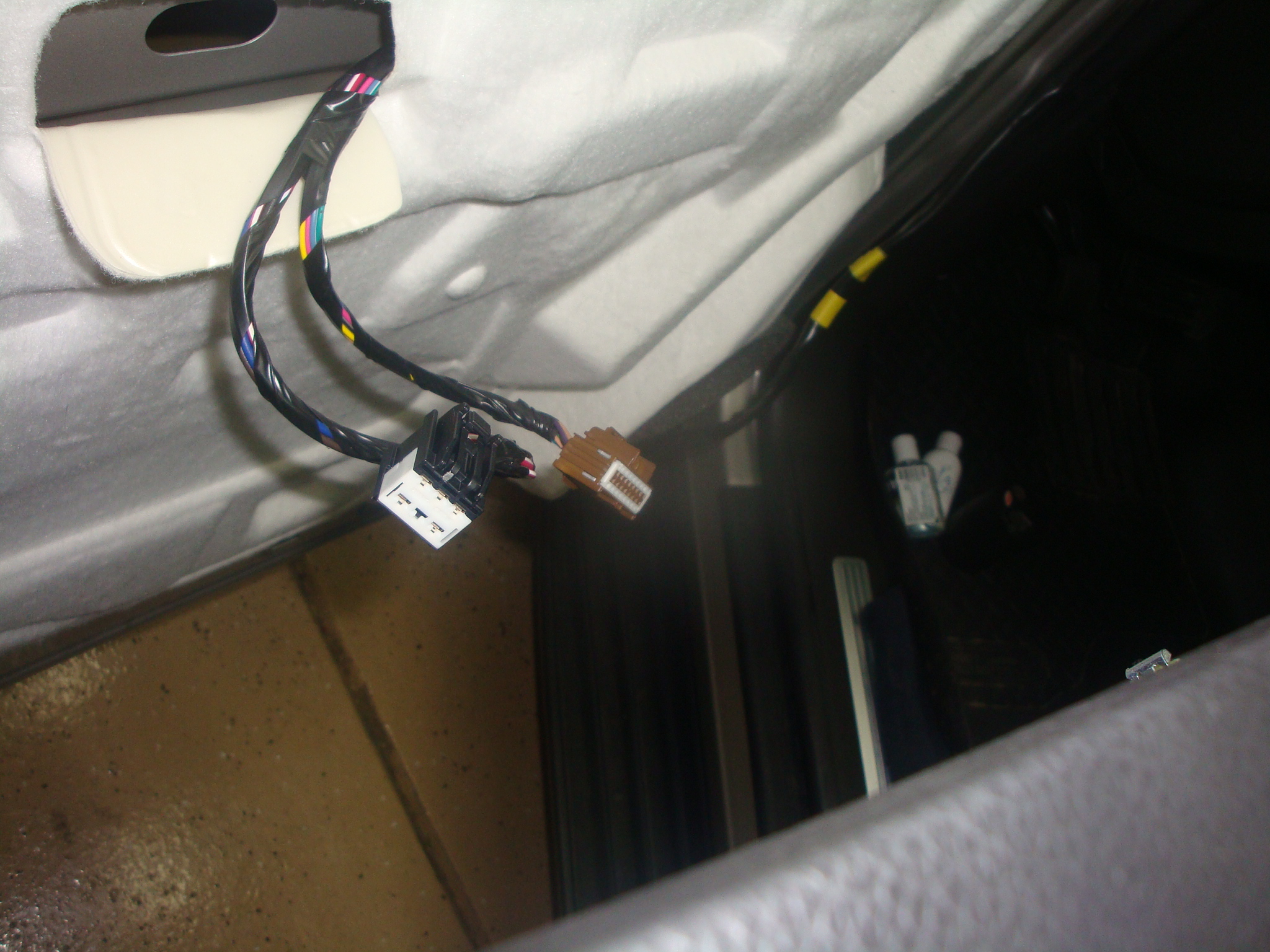

Thanks Sea,I looked at that, but still wondering if its possible to just do the mirrors without doing all the door panel work.no Like where did gm put the plug for the mirrors?under your window switchs Has anyone done it without removing the full panel?

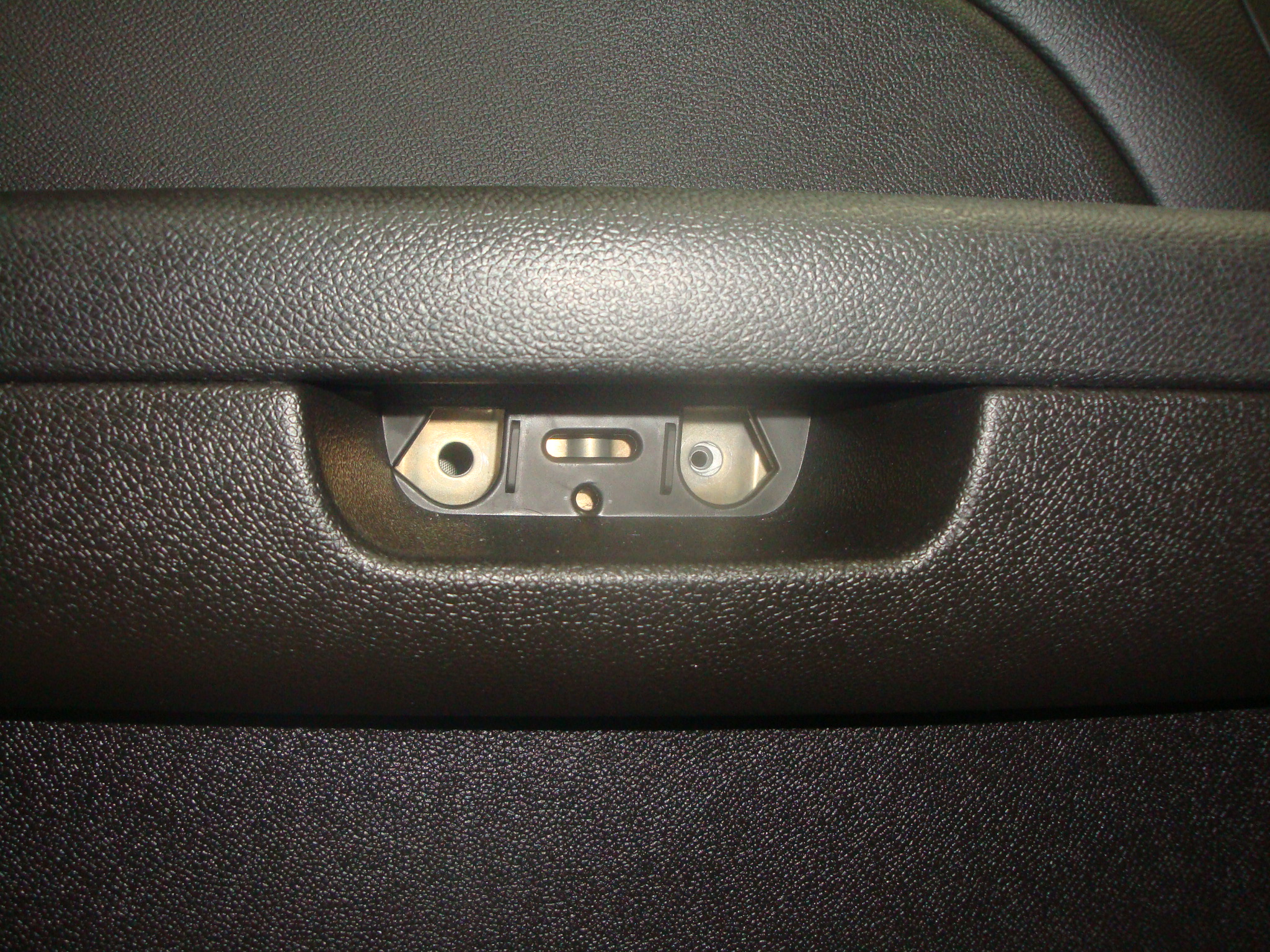

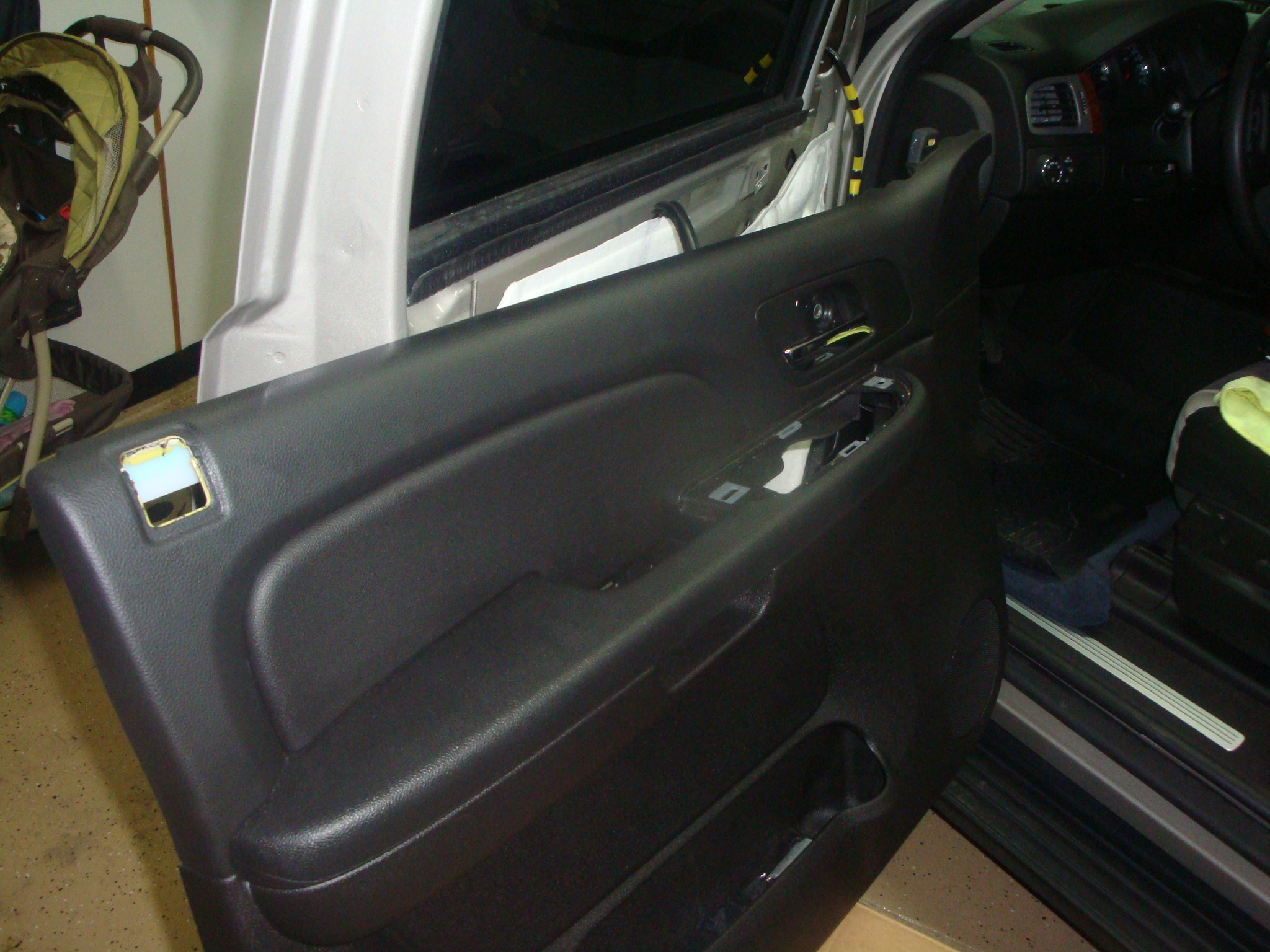

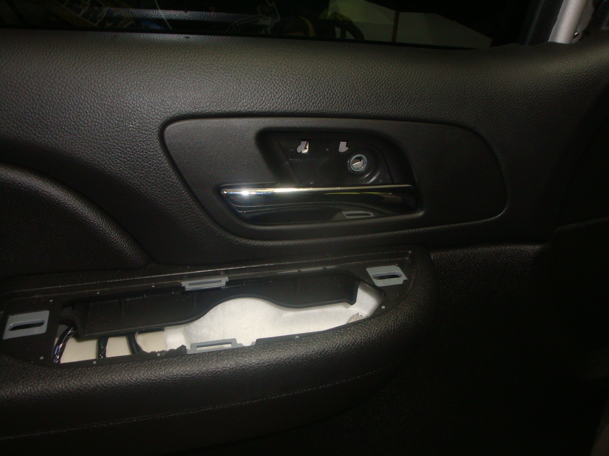

Here are some photos of the Tahoe (different trim but similar)
