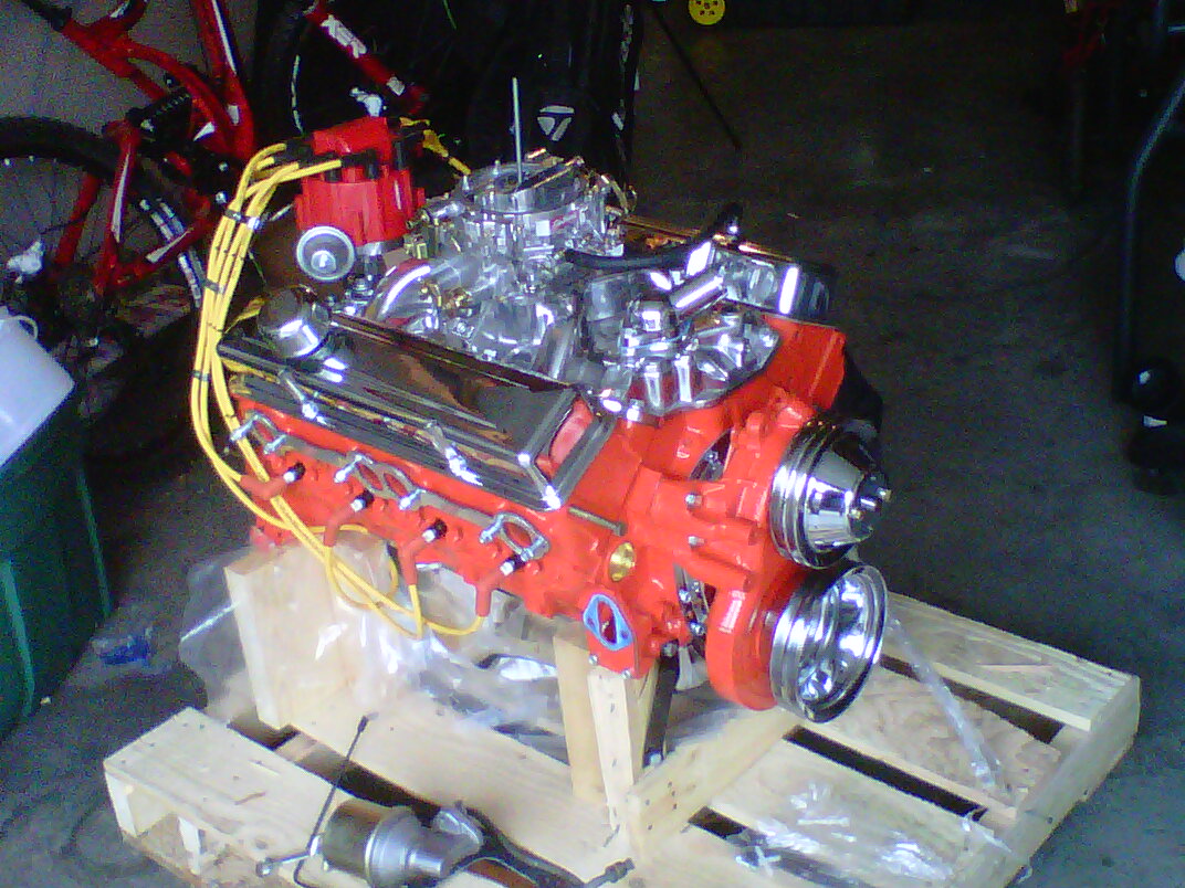

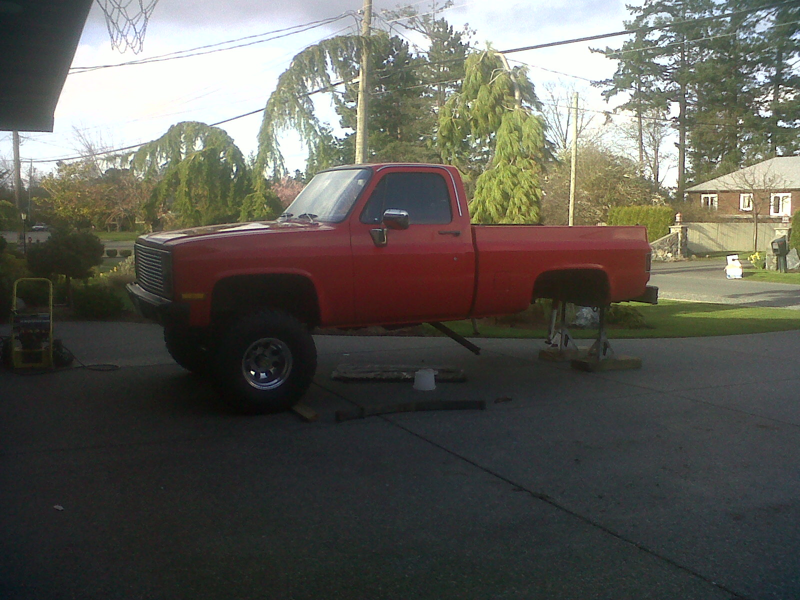

hey guys, been a while since I posted anything. Just in the midst of my rebuild project on the old chev. all drivetrain, suspention ( 6" leafs with 1" blocks I made for a custom lift), axles, brakes and interior being redone. 2 months and over 100 hours logged so far. And the new turn key 355 stroker arrives today! :dunno:

Right on thanks alot guys. Hoping to get it all back togeather this weekend. Just bolting up the flywheel and clutch right now. cant decide to go with the pilot bushing or the bearing, i have both. I hear the bushing is the better choice since it cant blow up and chew up everything, think i might choose that one. As far as the exhaust goes, Im torn between dumping them and side exits.

Awsome truck, I love to see the older Chvey's restored and tricked out. Here in NW PA there aren't many left, the salt eats the crap out of them. You have alot skill and that motor looks great. :(
Yea the truck was partially restored back in '98.. shop did the body work and paint so thats still in decent shape for now. as far as the mechanics go, im sure it wasnt done professionally as it was just a real crap thrown togeather job.

project update. engine in as well as trans and t case, all wiring and components installed except headers! my effin longtubes wouldent clear even though i have a mini starter motor on it, and block huggers hit my motor mount on the left side ofcourse. just waiting for some standard length ceramic coated hookers.
