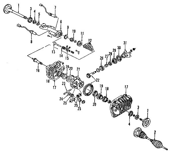

The front drive shaft can turn in 2wd it is just not forced to. The drivers side cv joint is always turning the diff output shaft on the driver side any time the wheel is turning. The drivers side output shaft is permanently linked the the spider gear opposite of the ring gear. The friction or resistance in the carrier determines wether the spider gears allow the differential to either differentiate or turn the carrier which results in the front drive shaft turning. The only thing that disengages in the front end is the passenger side output shaft. That way the left and right side front tires can spin independantly from one another without the spider gears coming into play.

um, no. It can turn with enough friction and speed like he said but it does not turn any time the vehicle is in motion. Mine generally doesn't turn at all. If our front diffs were lockers then the shaft would be forced to turn by the diff whether the right output shaft was engaged or not.
