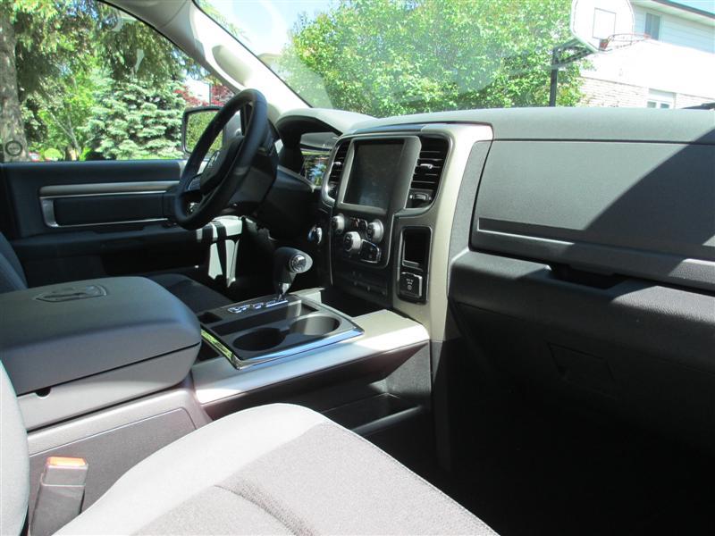

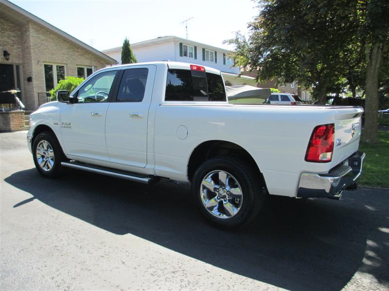

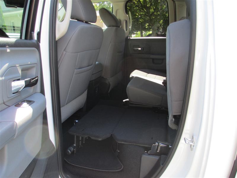

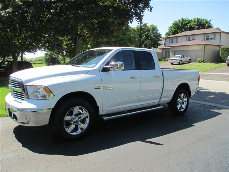

A real old post but thought I would update.
Long story short, after many issues with my 09 SLT that just wouldn't quit, I decided to trade it in a purchase a new Dodge Ram.
Not that they aren't without issues either, but after owning nothing but GM products since I turned 16 (now 49) I decided to give another manu a try.
So far so good but the truck has just over 300km's as I just picked it a week ago Wednesday.
I must say, this new Ram rides nicer, is smoother, and inside the cabin is much quieter.
My old 09 Sierra SLT truck issues were endles, namely the new motor, the oil leaks, one wheel replaced, one tire replaced (would not balance) a rear driver side door that I had to slam near the top to get it to close and in the winter time, I never used it as it wouldn't close!
2 fuel sending units, a front valance that was crooked from day one, seat adjusts felt like they were attached to crooked rods, rear squeeky leaf springs that wouldn't stop no matter how much lube I put on them, and completely gutless leaving from a stop light or trying to enter a Hwy!!
The straw that broke the camels back was this spring when I was washing it and noticed both side body side molding strips were coming away from the truck.
That was it, I didn't trust this truck any longer and with only 1 yr left on the power train warranty, I decided to flip it while it was still worth something.
Like I mentioned, my new truck has been awesome and makes me wish I would have purchased a Ram back in 09 instead of my Sierra.
This isn't a GM slam, I clearly got a lemon my last time around, but when I test drove a 13 Ram and found out how smooth, poweful and quiet it was, plus the metal, (bumper, panels etc) being considerbly thicker too, it was a no brainer imo.
Hope you guys never experience what I did, it was a looong frustrating ride with my last GM that I don't wish on anyone.
Take Care
