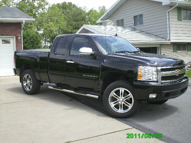

I just recently put a set of wheels and tires on my truck, 2010 1500, after I had installed my rc 2 in leveling kit, and it looks dang good but I want just a tad more height. Im thinking about a 1.5" body lift, whats the pros and cons of this? Anyone have this setup?

I paid $152 shipped from ebay for the RC 1.25" body lift, I also have the RC 2" leveling kit. Rolling on 275/60/20 Coopers LTZ's
