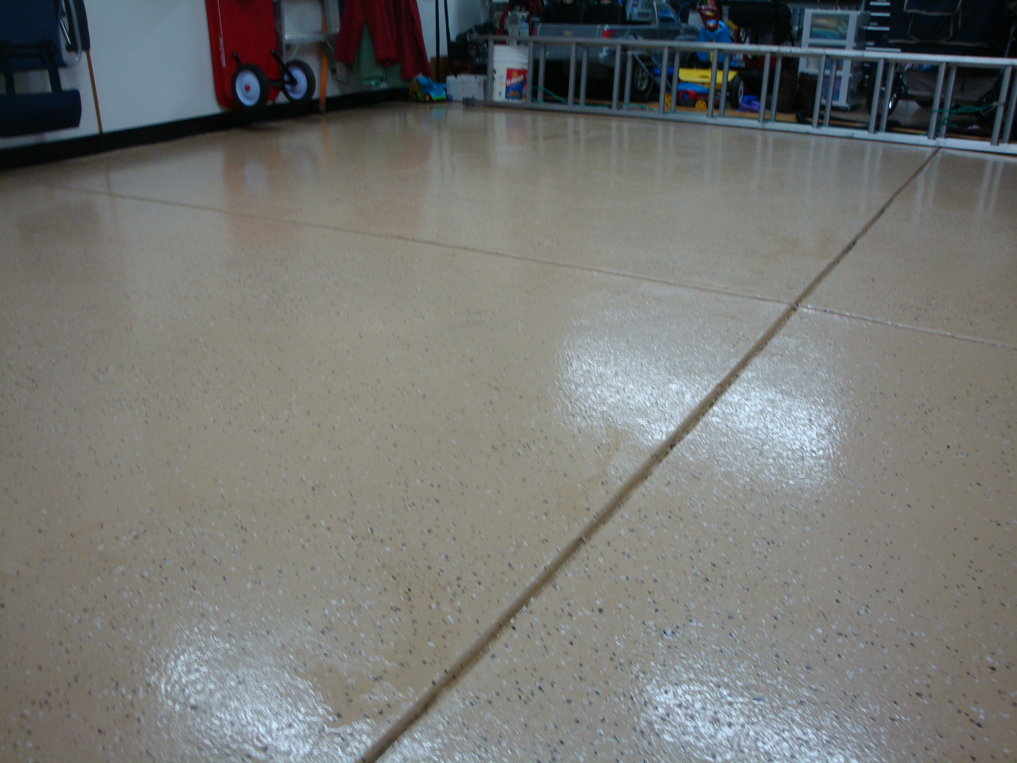

I did the standard kit and after 3 or 4 yrs it started peeling up, even after patching the areas that started to flake off. Last yr I re-coated with the professional and topped with the clearcoat, it is great, no more failing epoxy (my problem was from "hot" tires.). The professional is a thicker material. My only current issue is when I put the clear down last year I didnt mix the no-slip additive well enough and it was very slick, I slipped 3 times and hit the ground this winter. I am in the process of re-coating with another layer of clear with additonal anti-skid. I have done 2 out of my 3 car garage so far (see photos) and it is much better should have plenty of traction. Make sure to use the anit-skid on whatever top coat you use.
I did have a few chips from dropping heavy items that I have since patched and recleared over. A few chips are much better than entire sections coming up with the standard kit. Good luck.
The pic with the green bucket is how it was prior to washing and putting the new coat of clear on. The others are after shots.
Yeah, that looks great. If I go with Rustoleum I was leaning towards the professional version. Good advice about mixing in a bit of anti-skid in with the clear-coat. Thanks!

Clearcoat layer is completed. Here are a few photos.
No doubt that looks great! Thanks for the advice Ryan... especially about mixing in the anti-skid into the clear-coat. Now just to pick a color. At least with the rustoleum professional there are only four color options. Thinking the darker gray...
