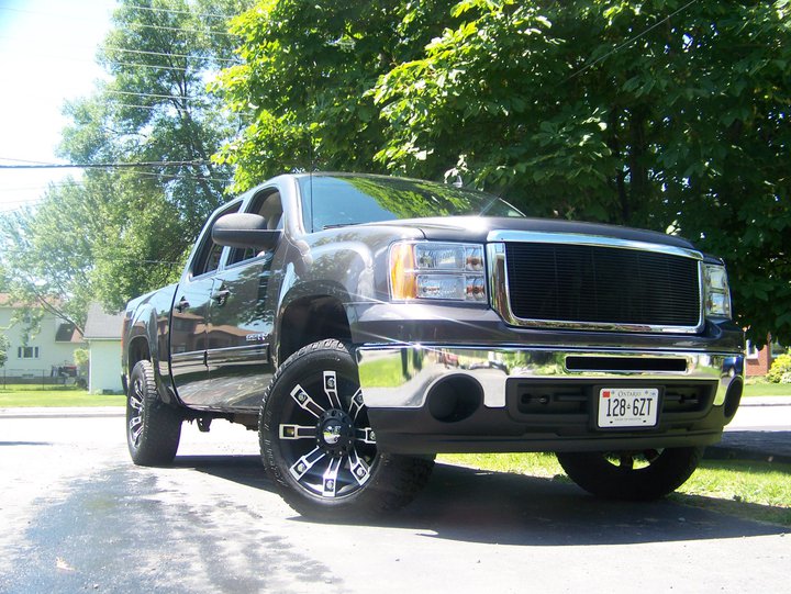

    • Love the look. I'm a SCSB lover myself.    Two items. 1.) A spacer changes scrub radius but this also changes when we use wheels of different offsets. A little isn't a big deal. 2.) Steel wheels, alloy wheels all have different thickness. Same effect on the stud and lug nut as a spacer. When hub centric the wheel isn't supported by the stud. It's supported by the hub. The stud just keeps it all together.
