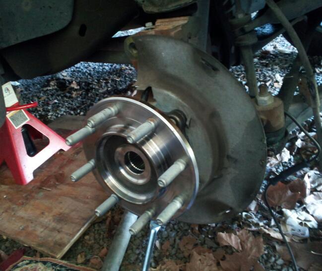

:thumbs::):thumbs:post-99261-1312687822_thumb.jpgpost-99261-1312687481_thumb.jpgToday i got the new wheel hub assemblies. It hurts to spend $600 at the autoparts for something like this, but small price for safety. Anyway, took a little longer than i thought (6hrs total), but it was super easy. Torquing the bolts wasn't that bad. The bearings were definitely going bad. When i spun the hub i could hear a clicking sound and a grinding sound. When i held on to the hub assembly by the mounting flange (knuckle side) while spinning the hub i could feel grinding and vibration. I'm glad it's done and now i have the knowledge of changing them. I appreciate everyone's help and information.
