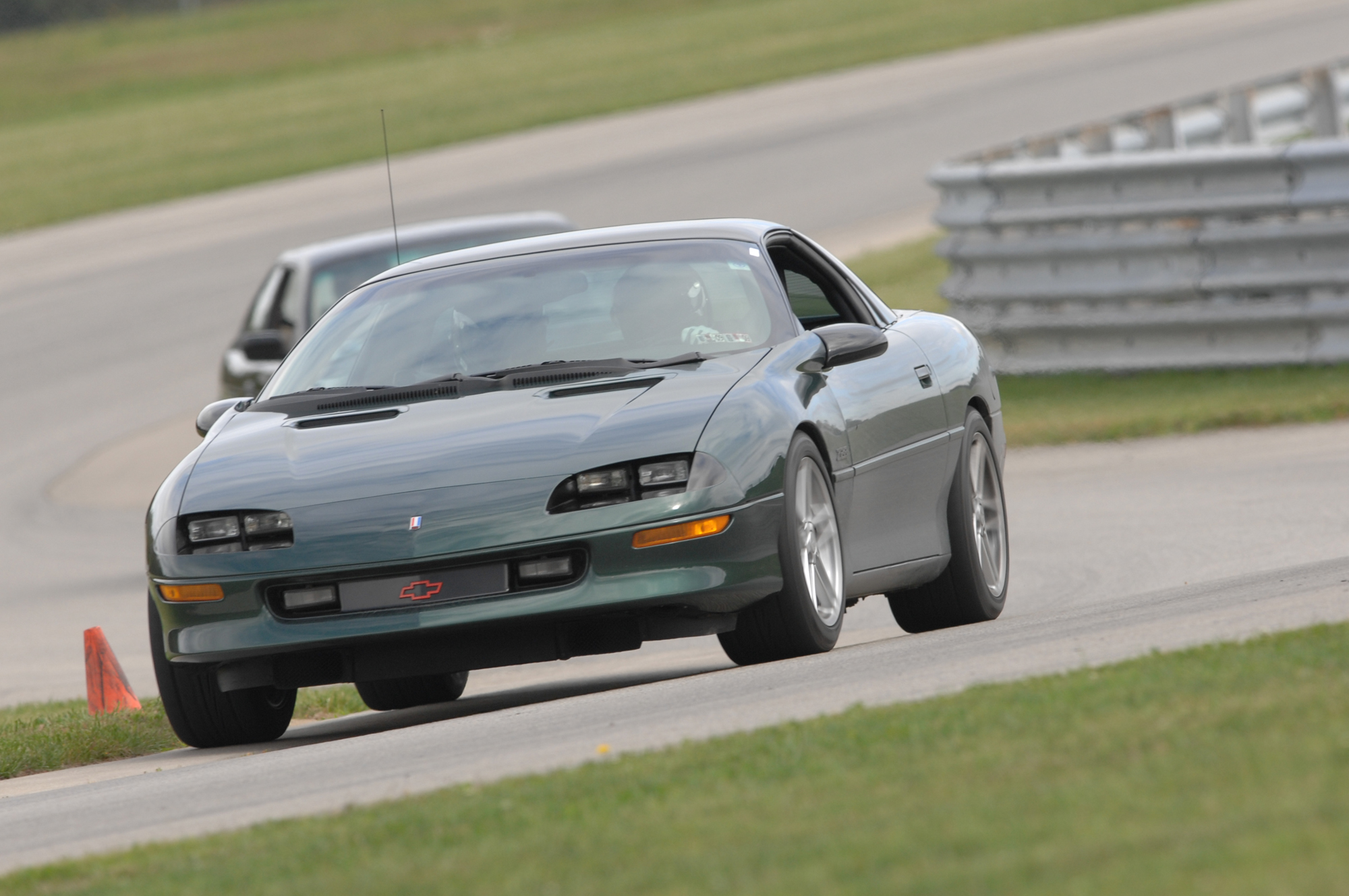

Spacers get a bad rap. Buy high quality, wheel/hub centric, CNC billet machined. You can buy the smaller thickness ones, but make sure your lug nuts will still have sufficient thread engagement. If you have to go with longer studs, and I'm not sure if anyone has them available, ARP was always my choice. Make sure hub and wheel are clean/flat and free of corrosion. Tighten with a accurate torque wrench! Can't believe Summit and Jegs still sell those terrible cast aluminum one size fits all spacers. I had spacers on this:
Well over 300 hard road racing track miles with lotsa street miles too, alot of F-Body (among others) guys use them, no failures.
