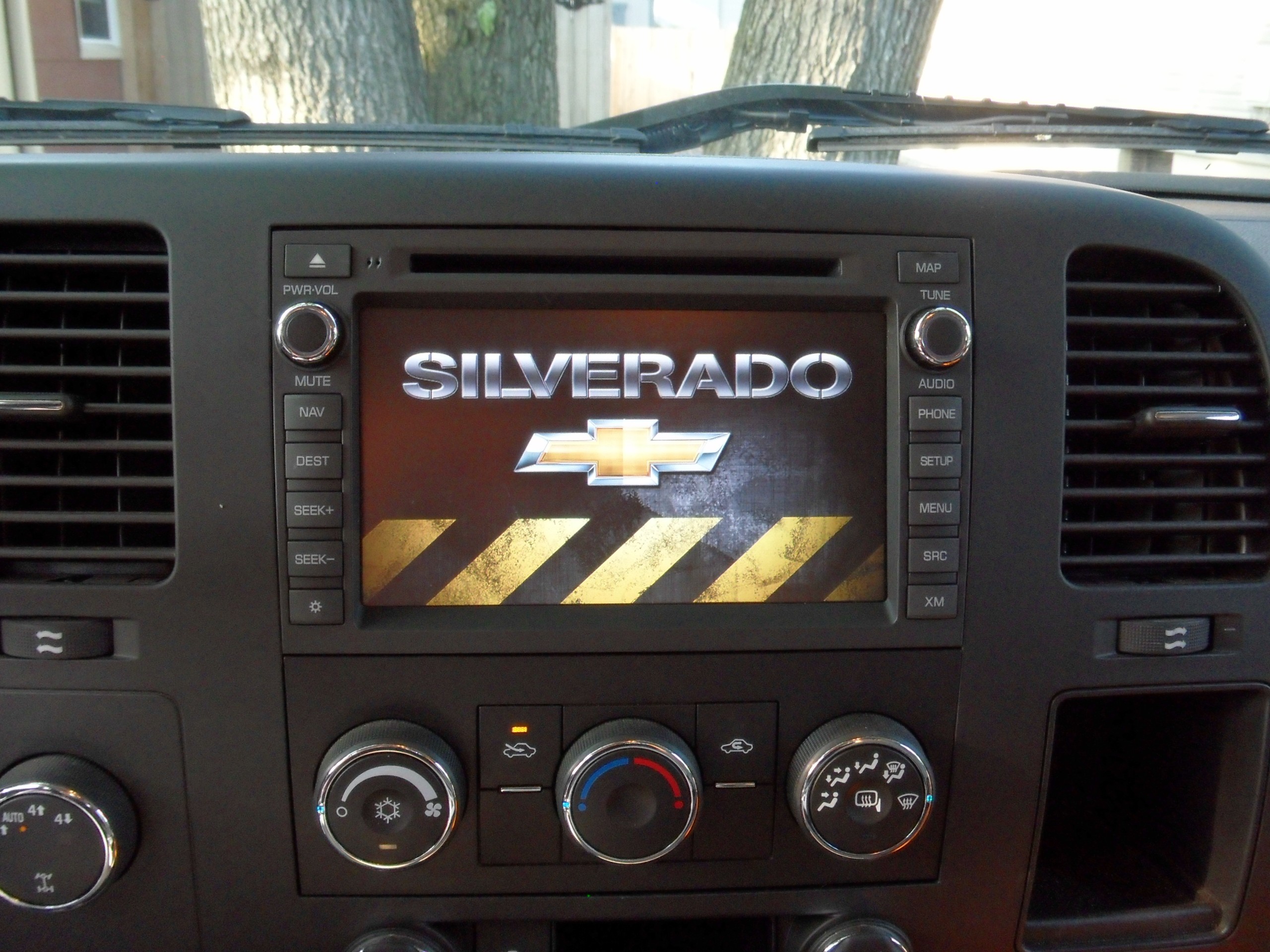

After numerous requests, I've added a page to our website that has a few downloadable splash screens we've made for the Advent OGM-1 navi, along with the instructions to install them:
http://www.adcmobile.com/support/advent-splash-screens/
NOTE OF CAUTION: DO NOT USE YOUR MAP SD CARD TO INSTALL THE SPLASH SCREEN FILE! USE A DIFFERENT SD CARD SO THERE IS NO POSSIBILITY OF CORRUPTING YOUR MAP DATABASE!
If anyone has ideas for a custom splash screen, email me (walt at adcmobile dot com) an 800x480 .jpg and I'll turn it into an installable file and post it for others to download.

Walt, I tried loading two different images with the same result, I get an "Invalid Package" error. It seems to find it ok after I press Update Image, a scroll bar quickly races by,but when it gets to 100% I get an error.
Any insight?
Thanks
Ernie

Did you remember to rename the file "@@@@LOGO.fll"? In other words, you have to drop the filename ahead of the four @ symbols because that's the only name the system recognizes.
If you did this, which files did you try and I'll do them myself.

I tried both the Silverado_Black and Silverado_Carbon and yes I did rename them.
Could it be something with downloading from the site is corrupting them? Maybe zip them up before posting?

Ernie,
I downloaded the same files and just installed them both:
I don't know what would cause this, but both seem to be working OK for me.
If you like, email me: walt at adcmobile dot com and I'll send them to you zipped to see if it makes any difference.
Walt
Got it. Tried a different SD card. Not sure if it was because the first (not the one with the maps) was > 4GB or because it had other things on it.
Thanks again!!
Ernie
