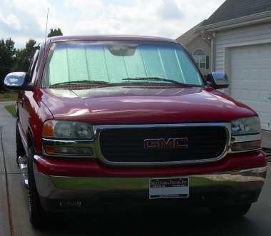

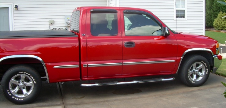

I recently purchased my first truck. It's a lightly-used '99 Sierra 1500 2WD Ext. Cab w/ a 5.3L V8. :-)
  • Steel wheels w/ chrome plating on front. Chrome is chipping off; back is rusting.
  • 285/60R16 111S Tires - Goodyear Eagle GT II, <50% tread left
Sadly, when doing an alignment, the tech said one of the rims is bent. I believe that this causes a shudder or wobble on the rear end, especially at certain speeds. So I'm looking to replace the rims, and possibly the tires. I was hoping to avoid tire replacement for a year or two due to the price, but the long term goal of getting the right size rims is more important. Also I don't want the bent rim to cause wear on other components.
EDIT: Tire Rack rep cleared up the miscommunication.
Looking at the pictures, what rims/tires would you advise? Feel free to make style suggestions. I'm partial to ATX Artillery or Slots if that helps.
I'm open to getting a lift kit installed. However, I do not want the end result (e.g. wheel size increase / 2 + lift) to raise the truck's body more than 4" from where it is. No one wants to keep a stepladder for climbing into the truck bed!
This weekend I'm headed to a body shop to get an estimate on some fixing some dents and lots of small paint chips/scratches/wear/bubbling. I will also inquire about fender flares. I'm open to having the body/fenders cut if that will allow bigger tires. If not I will probably have the flares installed anyway for protection from road debris.
Highway or low-noise all-terrain tires only, and they must have adequate load rating.

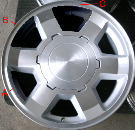

My price was accepted so the stock machined 17x7.5 +31mm wheels will arrive next week. $245 for the set. The savings vs. aftermarket wheels I wanted are enough to cover the fuel pump replacement bill, so I'm happy again. Tires will have to wait until I get the dealer to exorcise my possessed electronics.
Painting ideas, anyone? Two-tone, metallic, chrome, black chrome, matte, gloss etc.
EDIT:
The wheels haven't arrived yet, but I have created a preliminary list of things to do:
  1. Spray one side with oven cleaner, leave sit overnight, and rinse thoroughly next morning. Repeat for other side. (This is said to strip clearcoat, paint, grease, and other dirt from surfaces.) Wear gloves while spraying and wear clean gloves while handling (including using masking tape) to avoid transferring fingerprints to bare metal surfaces.
  2. Mask off spokes, rim, center/hub area, and angled surfaces intended for chrome. Spray one coat of etching primer. Spray several coats of black paint to exposed areas; finish with clearcoat. Remove masking tape while wet. Let dry overnight.
  3. Repeat procedure to mask off black areas and apply chrome paint to exposed areas.
I photo-edited some areas darker to see which angled surfaces I should paint black. I like option B because it would make the wheel appear larger yet preserve the angled edges of the spokes.

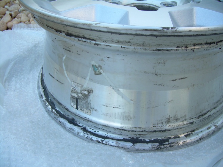

The wheels are here! The center caps have a top-half which appears to be made of aluminum. If that's true I may want to sand and polish the aluminum face on the wheels and caps for a mirror finish, then re-apply clearcoat.
I'm not sure how/if the rubber is to be removed from the tire-mounting area. :lol:
