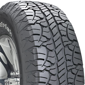

I've been looking for some 275/60/20 for my OEM GMC 20" rims. I know everyone here recommends the Cooper LTZ, but I've never owned Coopers but have had good experiences w/ BFGs on my Camaro.
On Discount Tire Direct, I was comparing the LTZ to the newish BFG Rugged Terrain. Both get great reviews. One thing that caught my eye was it appears the LTZ has a much larger contact patch due to the sidewall design versus the BFG. So I'm wondering if anyone knows whether or not the LTZ will appear wider than the BFG once they are mounted and have weight on them. In theory, with equal rim width and air pressure, the contact patch should be the same, but the design has thrown me off a bit. I'm not looking for recommendations on which tire is best, I'd just like any info on the widths given the sidewall design.
Cooper vs. BFG
I realize that the pics may not be the same tire size so don't compare the size, just the design.
First according to the cooper website the ltz doesn't come in 60 only 275/65/20 and 305/55/20 with the 275 being 10.8 section width and the 305 being 12.44 on a 8" wide rim. The BF does come in your size and the section width is 11 on a 8 inch rim. If you are looking for looks both look great with the ltz winning out slightly for a more sporty look. If you are looking for a longer wearing tire I think the BFG will get you more miles from the research I have done. I just put on a set of cooper discoverer at3's and I picked them for there 55k warranty and felt they had a good look also. And yes the picture is not going to be a good comparing tool because size is size pretty much but check out the specs on both manufactures pages to see actual dimensions.

Just FYI, I went by Discount Tire yesterday and looked at both of these tires in 275/60/20. The Cooper had a far wider contact patch. It looked a solid inch wider at a minimum. The tread design of the BFG looked more conservative and more oriented for street use, whereas the Cooper was more aggressive and was a good balance between on and off road. I think I'll be going with the Cooper.
Good choice those BFG look like street tires to me when mounted up.
