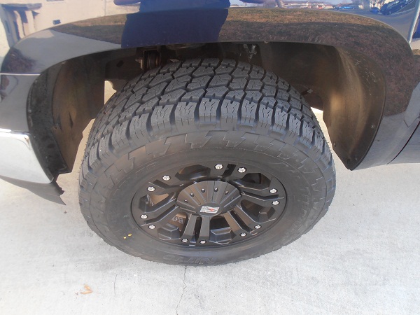

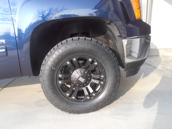

I had 305 60 18 cooper STT (32.5") on my 09 crew cab with a 2.5 ccm kit. Had them on XD Monsters with a +18 offset. No rubbing what so ever. Never had to trim anything
