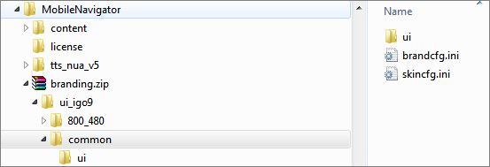

If you need guidance on how to unzip and edit a text file, you have some reading to do - I can't help you on that...
If you insert your SD card into a PC (don't know about Mac) and open "branding.zip", you see this file structure:

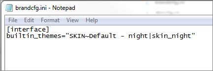

Inside "branding.zip>ui_igo9>common>brandcfg.ini" you'll see this:
You should be able to wipe that line out and re-save the modified "brandcfg.ini" inside the .zip file, which will eliminate the default night view on startup.
I modified the "brandcfg.ini" file and placed the Micro SD card back into the OGM1. Everything appears to be working normally. Like Walt indicated make a backup of the Micro SD card first.
