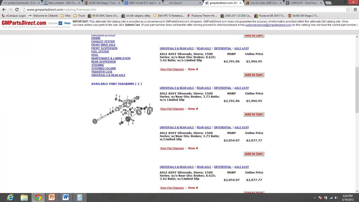

I am trying to go to almost full 06 VMax/NHT on my tuck. Engine/Trans/Axle/Leafs.
1. Did the 06 NHT have drums or discs on the rear?
2. I got a price on a GMT-900 NHT 14 bolt rear housing from a dealer that takes discs, but they won't give me a part number. Can I get this number?
3.Are the NHT springs different from the standard 3 leafs on the 1500's?
My guess is on a 2012 if it says disc brakes then it is the 14 bolt. Is this assumption correct? Showing 22847704 as the part number for the complete assembly

1. The '06 GMT800 NHT trucks had drums.
2. I can get you a part number when I get to the dealership tomorrow.
3. On the GMT900 NHT trucks yes,the springs are different,on the GMT800's I'm not sure,I'll have to check.
With my already purchased brake system I need discs so I guess it would be 07+ NHT. If you could tell me if that part number I gave is correct and what all it comes with, that would be great Rich

The GMT800 trucks all have the same rear leaf springs.
22847704 is a 9.5" rear axle listed for an NHT truck with the following items........3.73 ratio,rear discs,7,700 lb. brake system,G80 locking diff.,and JL4 Stabilitrak.
So what would be needed for to add brakes to this axle? Looks like I need the wheel studs, calipers, pads, rotors, but is there anything else. I would like to just do a quick swap,bleed brakes, and drive.
Local dealer said he could let it go for $2450
