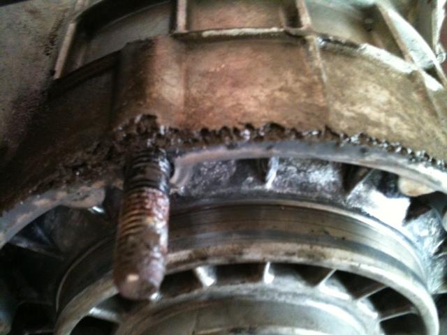

The gasket mating surface on the t-case is all different kinds of corroded..

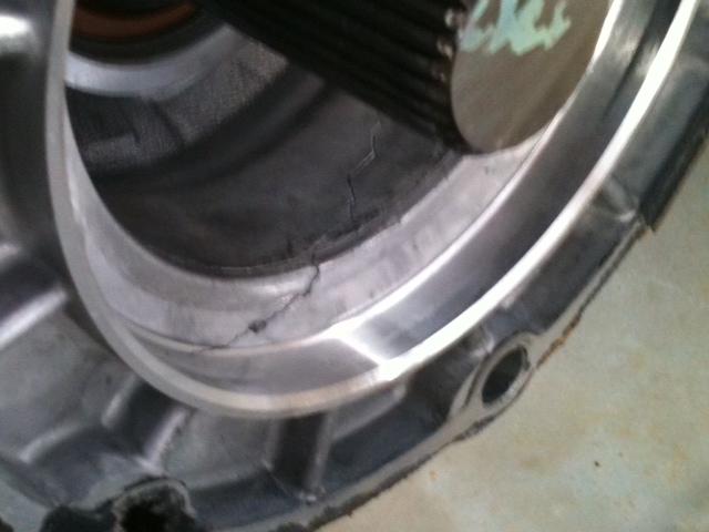

And upon further inspection, the thrashing of a rouge driveshaft apparently left a nice stress crack in the tailshaft housing on the transmission.
Now, I suppose this is aimed more towards the guys who've been inside a 4l80E.. If stress was enough to crack the tailshaft housing, what are the chances something deeper inside the transmission was affected? Also, where are guys buying transmission parts from? I found a couple places, but there prices were over $50 different for the same part.

change the adaptor ,i doubt very much anything happened inside ,,,change the t case front half,,its done,,,ya need all 3 seals as the front output shaft and front input shaft retaining rings are behind the seals ,,front output is a 2 pc seal and a PITA to get off
