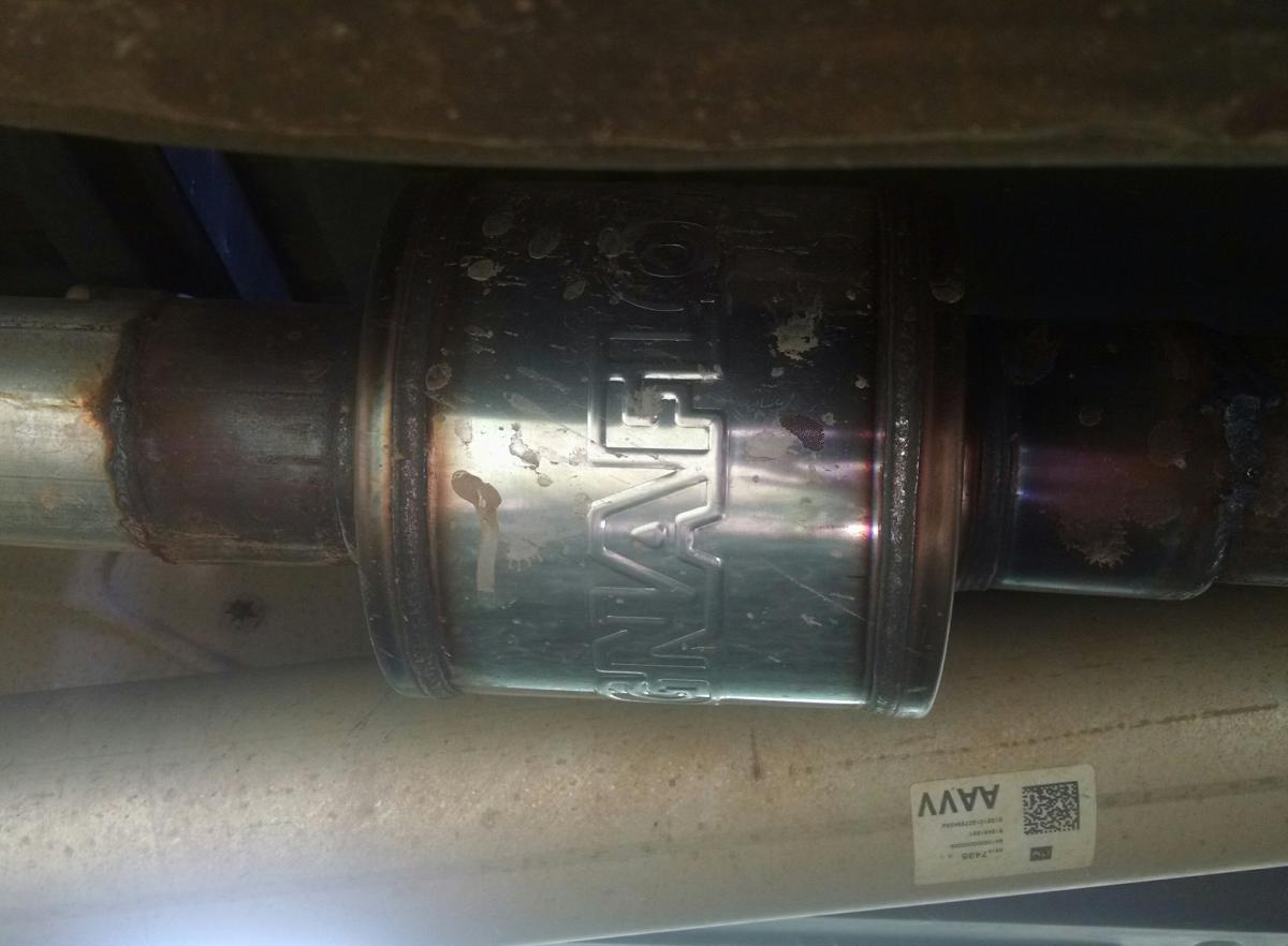

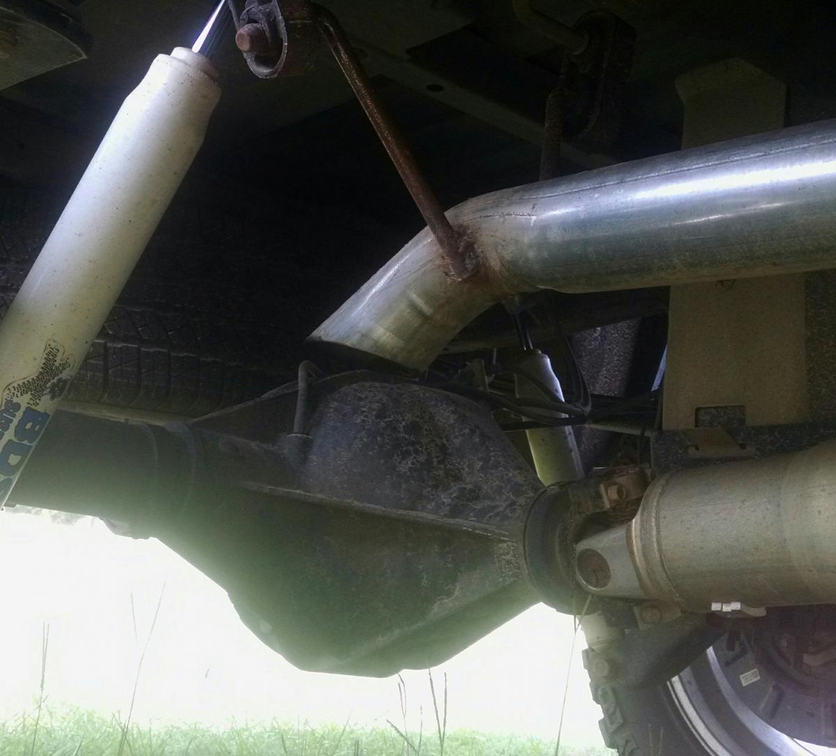

Changed out the exhaust again. No more duals out the rear. Was to quiet for me. Changed muffler also.
  • Replies 76
. What did you have and what did you replace it with?
If you go through my build. I had 18" magnaflow with dual outs. 5" tips. Now I have a small magnaflow muffler on and cut out the "third cat" with no turn down.
