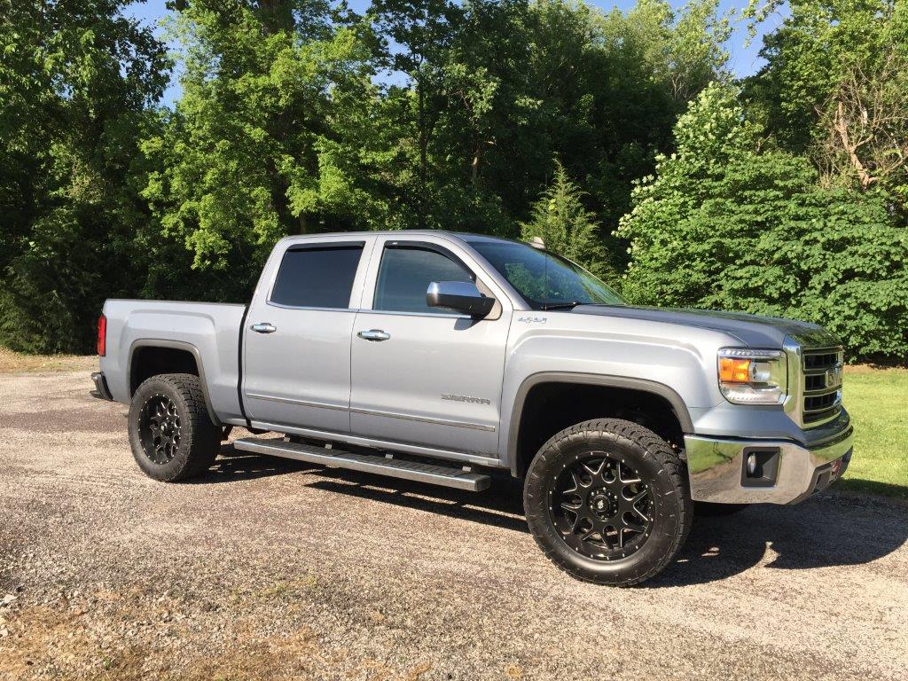

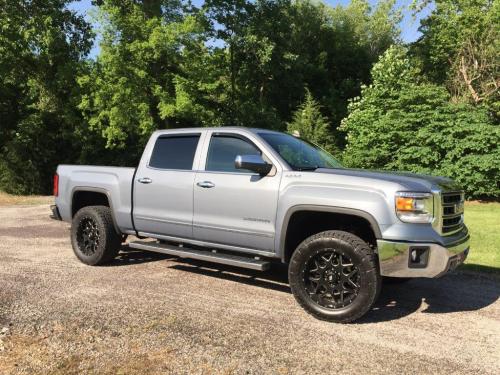

Bought a used 2015 Sierra SLT Z71 5.3 with a 2.5" Leveling Kit and 35s. I didn't have any issues for about 1,000 miles then the clicking started. Only when warm and I only notice it in parking lot or slow speeds, mainly because of the loud road noise.
I'm curious if I can still get any of this under warranty or a recall yet? Has anyone had any steering failures? I've been driving with it for about 1,500 miles, because I haven't had time to go by a dealership. Truck has 48,500 miles on it.
