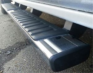

Anyone know if the rectangular steps from the 2014+ trucks will work on a 2012 HD? I am going to replace the 3" tubes with something larger, and I like the square steps, if not I guess I will go with the 6" ovals. Although looking at the MRPS of the rectangular ones is a bit steep.
2014HD has the same body and chassis as a 2012HD, shouldn't be any problems. Now a 2015HD has a new body on the same chassis and the steps mount to the body, so a 2015 step may not work.
The mounts are pretty much the same the position and size of the step pads are different because of the bigger crew cab. If you have factory molded mudflaps you may clear them fine. 2013 boards on a 2014 truck(new body) don't work with the factory molded mudflaps on the new truck, and the board sits closer to the front tire.
2013HD and 2014HD are the same trucks (only 1500's changed on 2014 model year). 2015HD is the new body style in the HD's.
Aware. I made that statement based off of 2013 boards that went on a 2014 1/2 ton which is the same cab as a 2015 HD.
