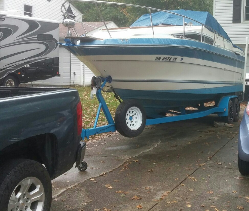

I should also add that I had the boat delivered and yesterday I hooked it up to the older silverado just to back it up the driveway closer to the house and the truck sunk so low that I could not fold up the wheel on the front of the trailer. I'm assuming the new sierra won't sink so low when I lower the trailer on it

There's no way to tell exactly how low the truck will squat when you hook up to the boat, but it won't hurt anything. You could ask the boat dealer what the tongue weight is. It would be neat to see pictures hooked up and unhooked to see how far the boat pulls the pickup down.
My old truck (which I'm keeping for dirty work) is a 2008 silverado 1500 2wd WT with 6 cyl and 3.08 axle ( I think). Nothing fancy. I assumed the way it sunk was BC the suspension was not made for towing or offroad. I'm hoping the new truck won't sink so low. I understand the new truck has Z71 which comes with upgraded shocks and stabilizers. Thays what I'm hoping someone here could explain to me!

Just a little worried on how much my old truck sank from the weight and hoping my new truck won't sink so low

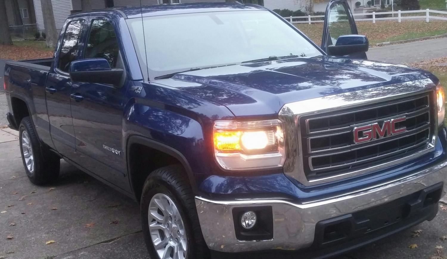

Thanks guys, I feel confident now. Just got the call the truck is on its way! I will throw a picture up when it arrives
