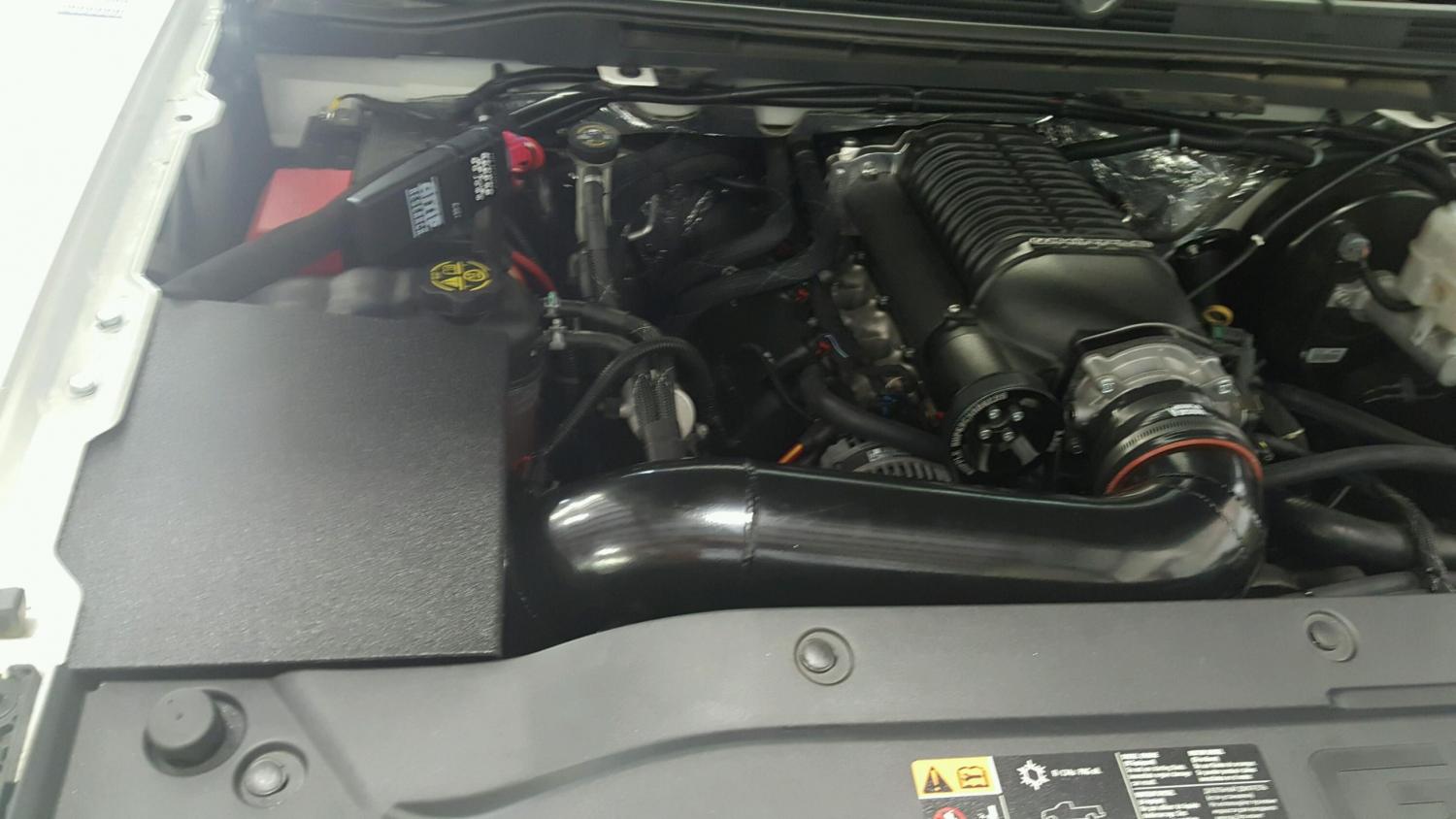

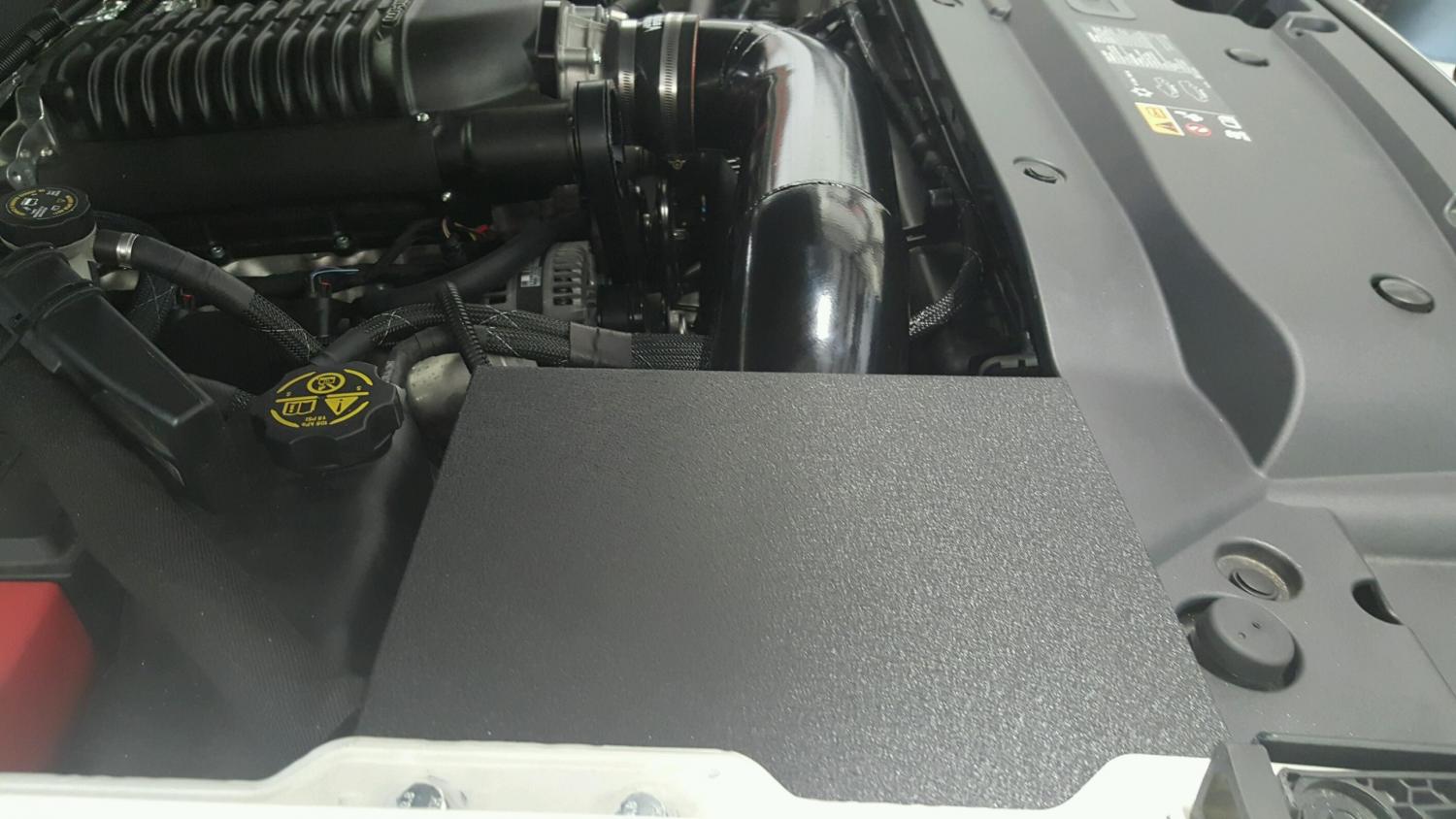

its getting closer.....New 4.5 inch cold air, cam and converter installed.

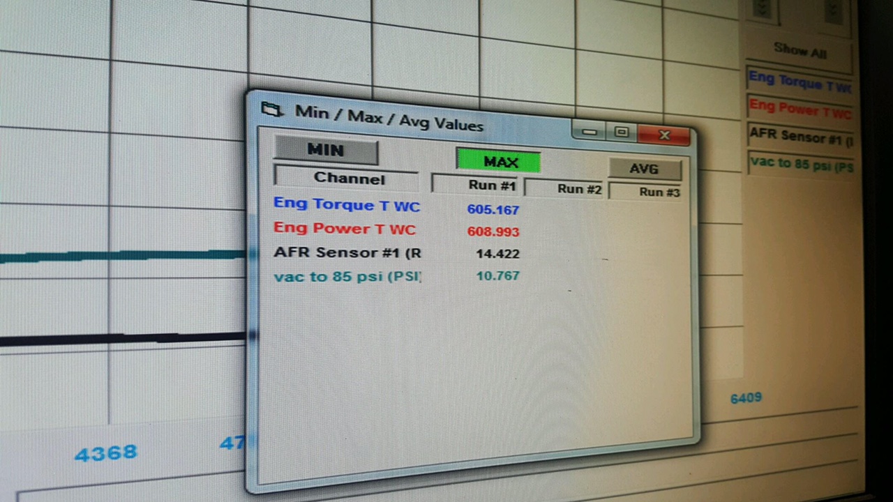

RWH 608 and torque at 603 at 10.7 PSI
Was getting marginal on fuel so getting a new pump and injectors installed....then I will pulley down one more size to about 11ish PSI
She sure sounds good now....Next week!!
