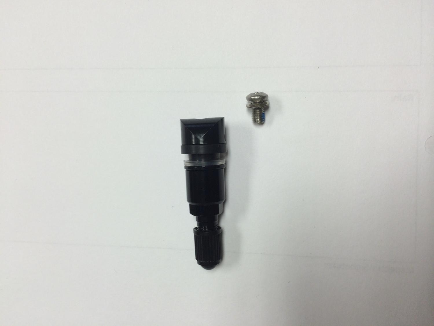

I'm changing wheels soon and wondered if there was a compatible TPMS sensor with a screw together metal stem like pictured.
!BU6u-h!!2k~$(KGrHgoOKiIEjlLmWN(BBKP76oh
Absolutely. The stems are independent from the sensors and attach with a screw to the base of the valve stem. Any auto parts store has them in stock in both styles. If you are getting Alloys rims these type are better, the rubber ones work better in steel rims.
