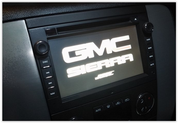

The most frustrating thing about the install was trying to cram all the cables behind the unit. Other then that install was pretty easy. Note; if your truck did not come with a Navigation system from the factory you'll have to install the GPS antenna under the dash (located to the right of the defrost vent). Below I posted a picture of that. If you have the upscale interior as my SLT does, GM has a nice little shelf to mount the GPS antenna. I've posted a picture of a splash/startup screen I made every time my unit boots. I can not say enough good things about this unit. I original wanted the factory unit (too expensive), then I wanted the Advent OGM1 (too hard to find and no longer making the unit) and so I finally went with this unit. If you decide to purchase this unit you will not regret it and purchase it through Amazon as it was the cheapest price I found.
