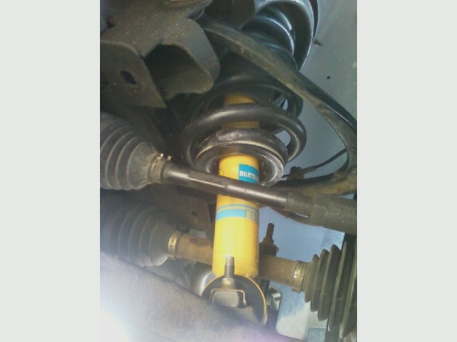

Yep - forgot to mention that. At 50k miles, one of the front struts was already blown - I would have never known if I wasn't doing a Bilstein upgrade at the time.
post-65085-0-34076000-1427195567_thumb.jpg post-65085-0-97849800-1427195579_thumb.jpg
It's good that you had the ball joints taken care of but don't expect much from those $18 shocks.

I installed these Gabriel's on my older s10 and they were fine w 60k miles on the shocks before I sold the s10. I use my Silverado just like I did my s10, mostly commute, sometimes I haul but nothing significant, I have nothing to tow, and no off road. So basically, I use my truck like a car. Now if I did tow, haul, and off road, I would go bilsteins all day. Plus these Gabriel's have lifetime warranty. I do the labor myself.
We have to replace shocks up here every 30k usually, because our roads are such s**t. With all the tax money they collect, our streets should be paved with 24k gold ... but I digress ...
Even with that, I expect struts to at least make it 70 -80k miles, since they are usually of a bigger, beefier construction, and more difficult to change vs. a traditional shock absorber.
