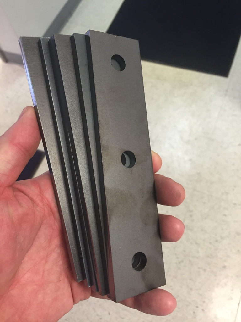

I ran into a similar issue with my Go Rhino D2 steps, except mine were getting hit by my tires when I put 35's on. If N-fab's mount similar to the D3's you can make a bracket modification to move the step back. I had these plates made to bolt up to the step bracket and then mounted the step to the back two holes. Moved the step back 2 1/2".post-93169-142800985187_thumb.jpgpost-93169-142800986729_thumb.jpg
Here is a picture from below of how things mounted. The custom piece is coated in rubber undercoat and paint, so it looks similar to the line-x on the step.post-93169-142801018234_thumb.jpg
Edit: I just saw you have the full length bars and the back flare is the problem... May not be able to shift step without making the front flare an issue.
