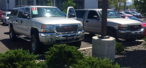

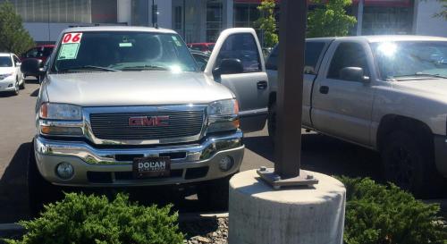

That is my 2006 GMC Sierra Work Truck next to it. I have always said that if I could find the 4 door version of it I would buy it. It had 113,000 miles on the 4.3L V6, 4X4, roll down windows, and 33" BFG A/Ts. I traded it in to get the Vortex Max. It was a great truck and I put 110,000 of those miles on myself. I hope this Vortex Max will be just as good of a truck!
