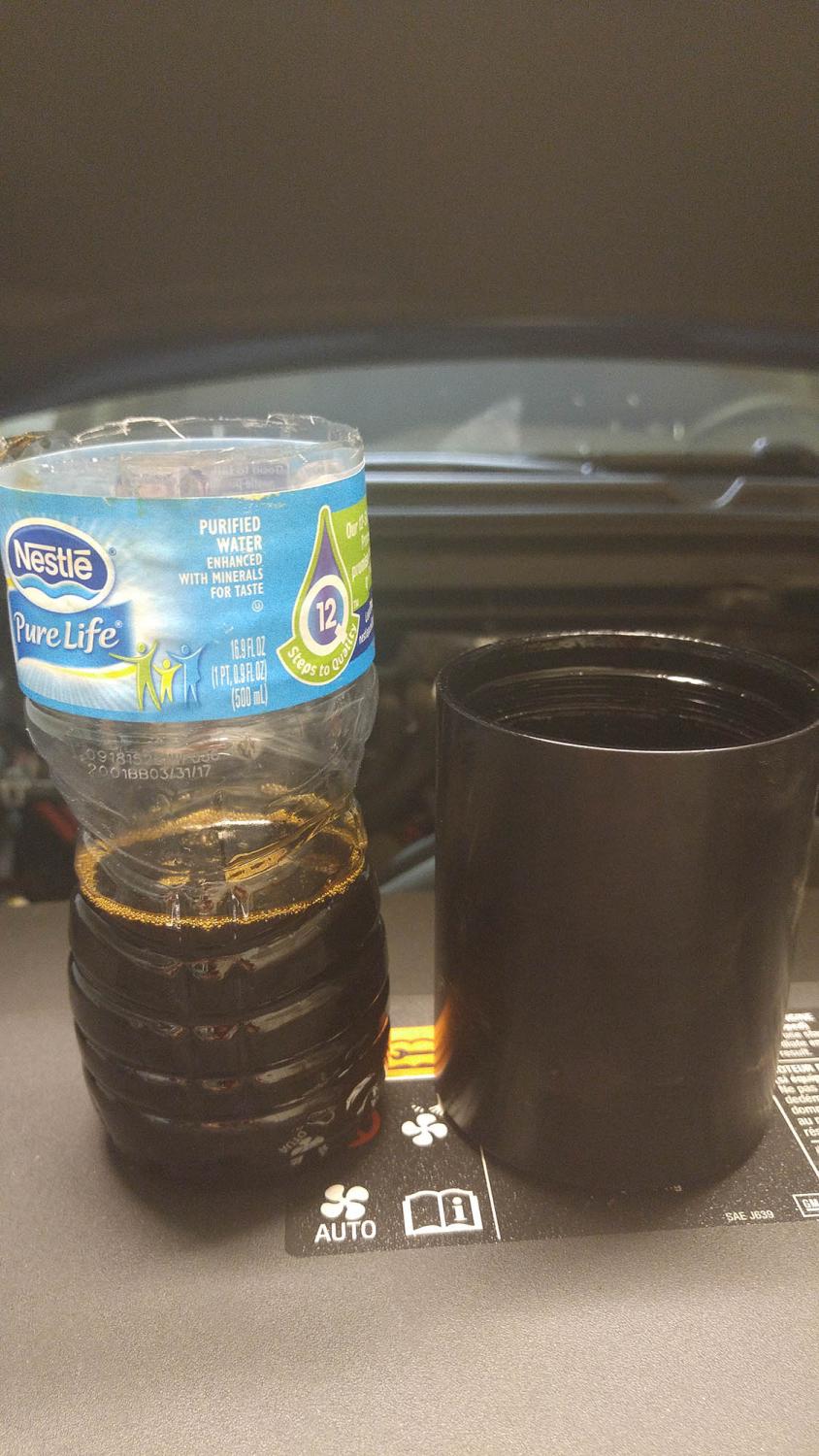

Hard to quantify exactly how much it helps, but I get at least 4oz of an oil/water (looks heavily oil) a month out of mine. The noticeable drop in power and mileage I've experienced from valve deposits hasn't returned, but it's only been about 10k miles so jury is out.

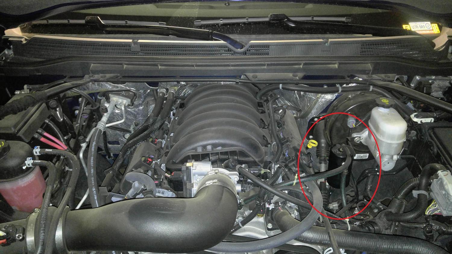

If you are handy at all, shouldn't take but about 15 mins. Of course, a lot of that depends on mounting choice. I'll get pics tomorrow. Basically you hang the can somewhere, and run two vacuum hoses over to the TB and intake area (just TB for 6.2's).
