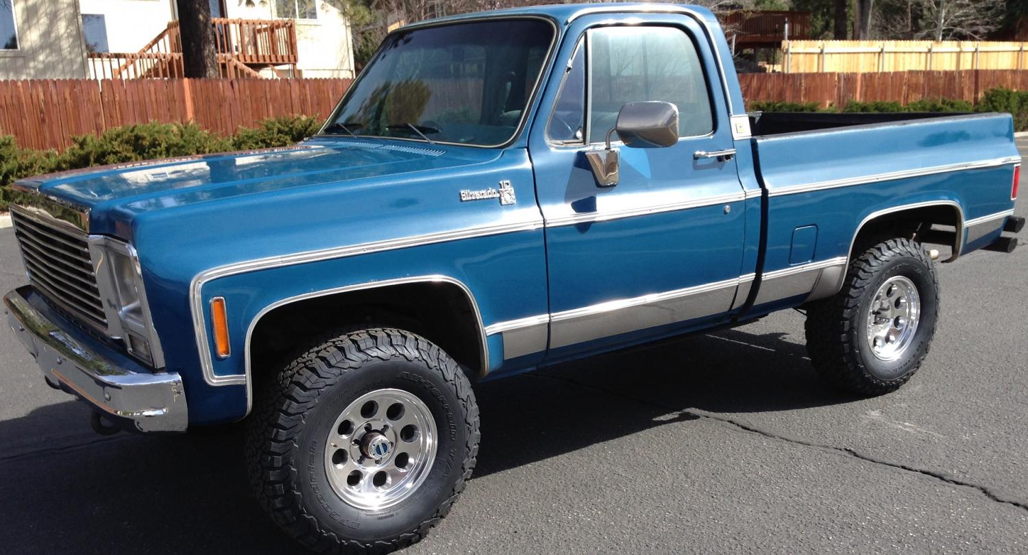

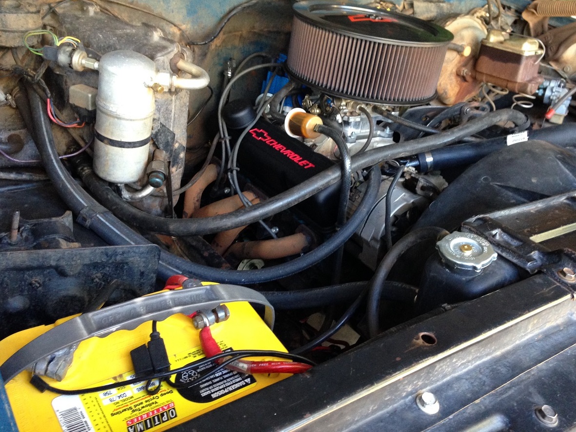

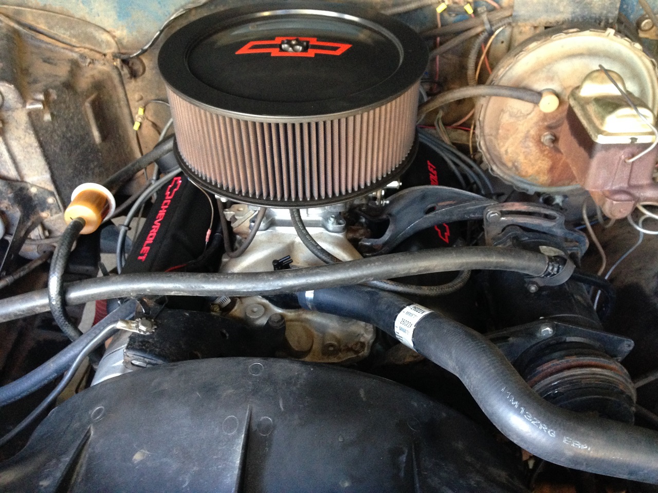

Here's a few pics because posts are better with pics!
According to the local landfill scale, the truck weighs 5,080 lbs with both tanks full.
