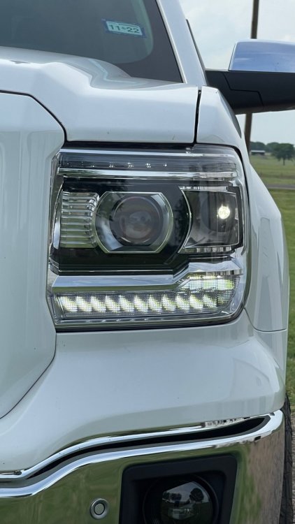

I followed the retrofitsource and used Klearz smoked lens to mine. The most important part of taking them apart in my opinion is patience. You don’t want to pry too much and start bending the cavity where the lens sits because then you might have problems with sealing the back properly. Just take your time and don’t worry if you have to keep putting them back in the oven they will come apart a little a time.90dfa99a7282d36b13d575778109b0a0.jpg8a117b74fbf88a4d8893389f17d03a6a.jpg
Definitely you have to keep the temp up as permaseal doesn’t soften. It isn’t a normal butyl type sealant. If you pry on channel you can use a heat gun and shape it back into shape but all In all its the plastic channel that will allow you to get to where the lense is to take off.
I havent done new truck lights but I prefer using a heat gun on my 04 yukon. Did a quad projector retrofit on it. Just heat the seam with a heat gun and once it's hot start spreading with a screw driver or a plastic pry tool.

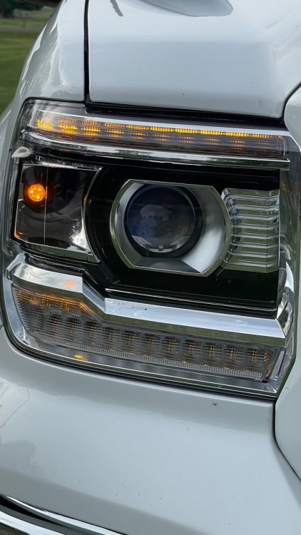

The LED bars on each side apparently have come loose.  Its very noticeable at night.  I am considering painting the chrome if I do get them apart.  I purchased them previously converted.
