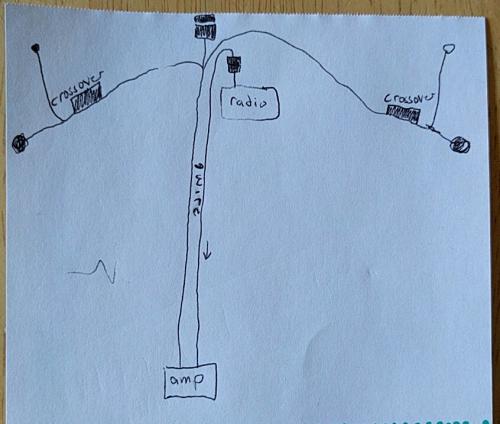

This is how I plan on bypassing the front wiring. Run a nine wire from and to the metra connectors. I'll be pulling the front wires before the go back to the fa Tory harness which will bypass the kickpanel wiring. Then I can run the wires from the nine wire to a crossover and to the doors and dash.
That's basically my plan as well. I'll be running 9-wire to a JL Audio Cleansweep. Then over to an amp and the crossovers. 9-wire from the crossovers back up into the dash area. I'm hoping to use the factory door wire for the woofer and run a new wire from the crossovers to the new tweeters. I'm just hoping when I unplug the factory dash speaker there isn't anything else inline with the door speaker wire, as I know they are tied together somewhere.

Don't think the front speakers are wired in series, I tried running just the doors (without dash speakers), worked fine. Both dash and doors are fed from one output off the head unit.
Got it. Thanks. I think I might have just blown the speaker. I'll check it out!
