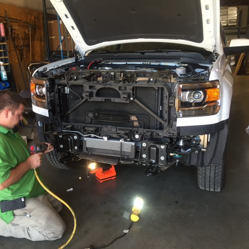

Could anyone provide front bumper removal instructions for a 2015 Sierra SLT? I have a put a little dent in the chrome that is driving me nuts. I searched, but didn't see any topics on the actual removal steps. Thanks in advance.
Its not to difficult, look on you tube that's what I did before I swapped out bumpers on my sierra. There are a couple videos showing guys doing the removal. Pull the black top cover thing over the radiator, carefully remove front grill be gentle don't break the tabs. Then you can access some bolts from the top, undo your fog light quick connections and the rest you should see what to do. Get a impact tool to. My stock bumper weighed 70 lbs so you could a extra pair of hands to assist right at the final part.
