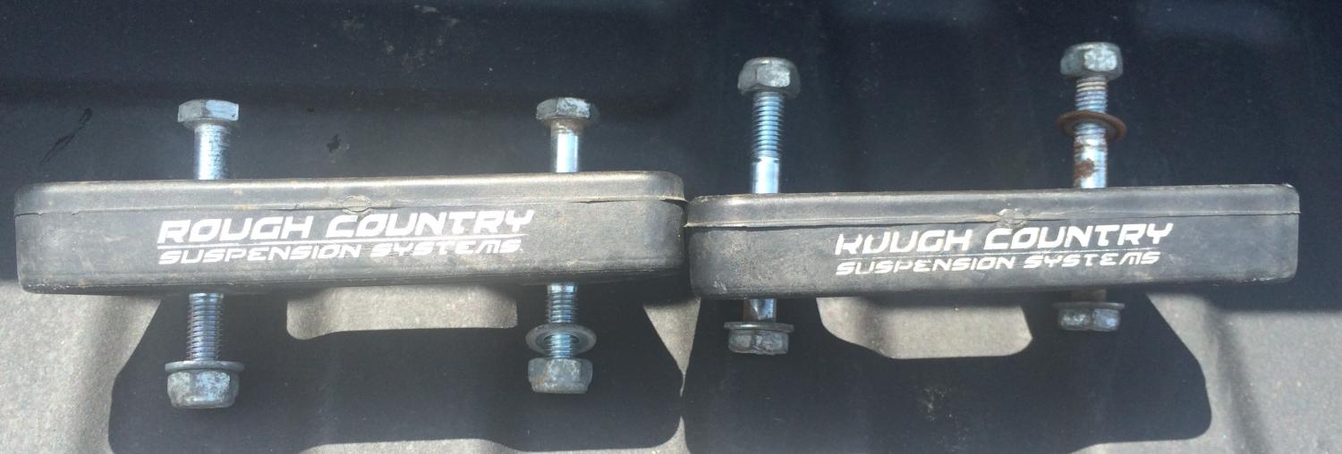

For budget leveling spacers, Rough Country and Zone Offroad make good products. Ready Lift is good too, but they're over-priced. The spacers that mount under the strut are easier to install that the ones that mount on top. Some kits (mostly the ones over 2") include spacers above and below the strut, which would be even more work to install. If you're able to spend a little more money, then Bilstein and Rancho both make kits that replace the entire strut assembly and provide enough lift to level the truck. From what I hear, the last two kits I mentioned will yield a much better ride than the spacer kits.
