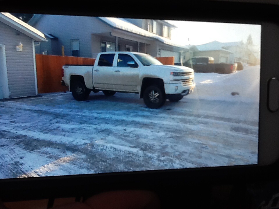

I have a 2016 Silverado 1500 LTZ z71 with a 6.2 I just got the dealer to put in a tuff country 4 inch and my oem 20inch rims hit the control arm at full lock and I don't want to buy new rims because I have a set of 20inch winter tire with the same offset as text oem not sure if a half inch wheel spacer will work and I can't get my truck from the dealer unless it's fixed other new rim or spacer the lift kit is the same as a readylift. Sorry if this has bin ask but I could not find the answer I'm looking for
6mm or 8mm spacers should alleviate it and are safe to run. I'm running 8mm spacers on mine and still had 7 turns on the lug nuts.
lots of the lift kits out say they are not compatible with stock wheels. sorry. or use spacers.
