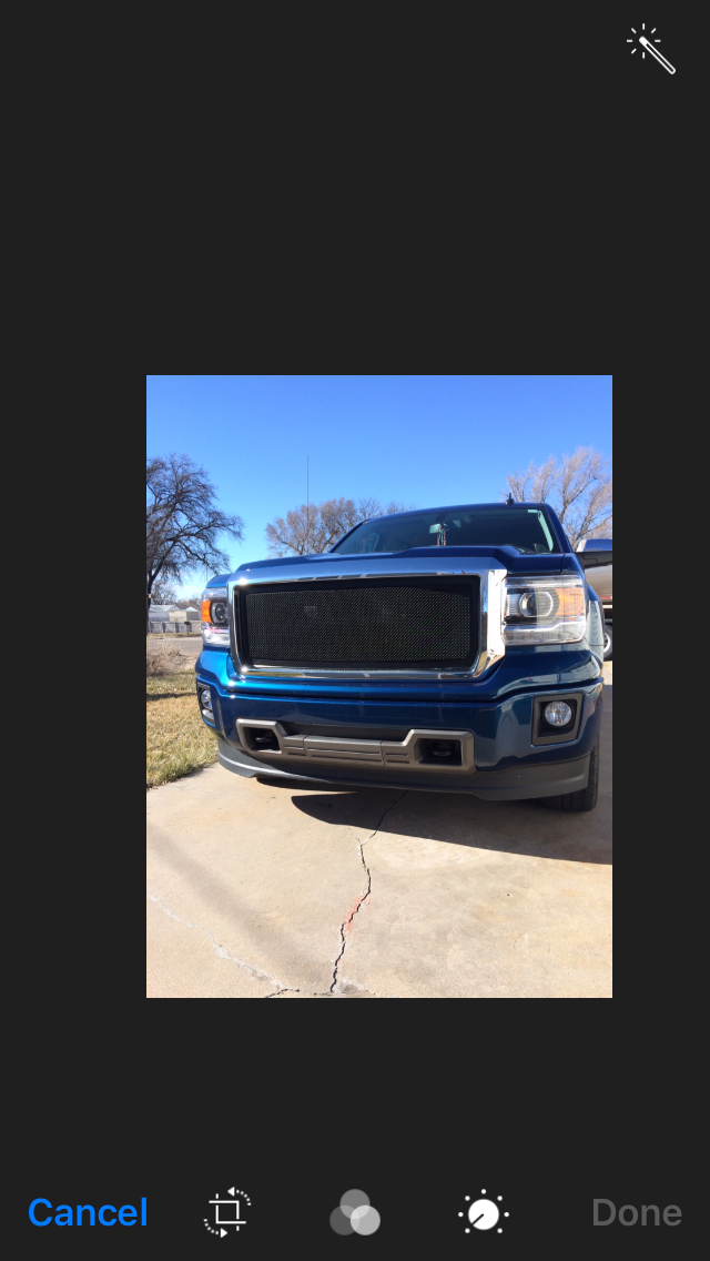

Need input on what I should do. Front grille looks plain and tow hook plastic needs painted or maybe a black one would look better. Ideas maybe gmc painted letters to match...? Also I hate how u can see through grille...? Ideas grille is a trex black mesh insert. Tried posting pic and it says it's too big
