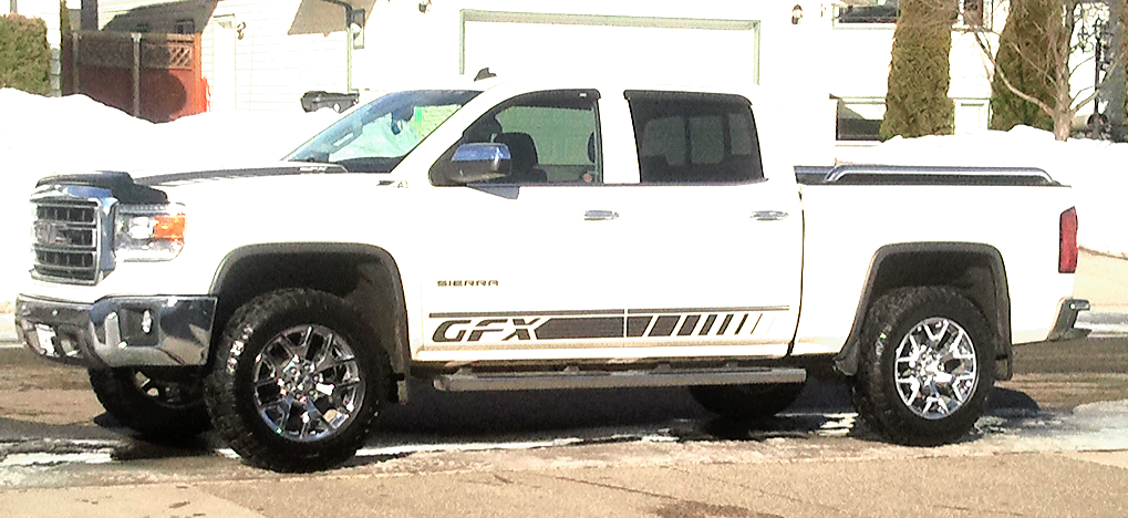

Will this wheel/tire package fit with 2.5 RC lift?
So I went to my local tire dealer and they are getting me a great deal on a wheel and tire package. I want the XD811 wheels in black with 275/65/20 BFG KO2's (possibly duratracs). The wheels have an offset of 18mm. Will I see any major issues with this set on a 2.5 Rough Country lift kit?
Yes it will most definitely fit. You may have rubbing at full lock in reverse but the zip tie mod of the wheel liners will solve that. Just go with that offset. Don't get a +1 or negative offset. Stay around a 14 18 20 or something like that.
Yep and that's for sure. I had a 14 Silverado with 275 65 20 with fur Mavericks +20mm offset and that's how it was. I'm actually going to try a 295 60 20 on a +14 offset on my current truck and hope it works.
