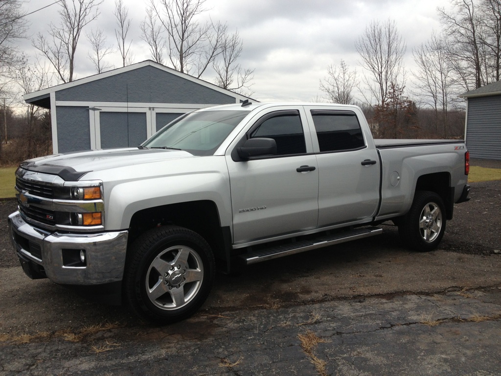

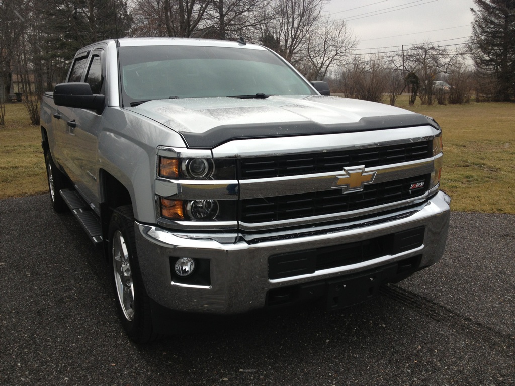

Hi Everybody,
I'm new here. I have a question. Is it possible to get the mirrors I bought for my truck to function fully. My truck has the DL8 power adjusting and heated function. The new mirrors I bought are DL3. They have power adjusting, heated, integrated turn signals, puddle lamp and power folding. These new mirrors even came with the wiring that the guy had for them. I had to replace my factory switch with a switch GM# 23154702. This was what the dealers parts dept said it called for. So, after changing everything over to the new set up, I have the integrated signals and my drivers mirror moved up and down and that it. NO other functions work except the puddle lights do light up, but doesn't seem very bright. I took it to the dealer to see if the computer needed flashed and they said I was SOL. Has anybody come across this problem or does anybody know a solution? All help would be appreciated...
