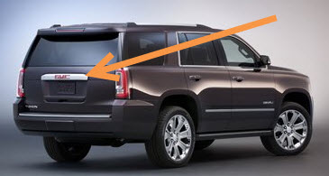

Is the chrome cover with GMC writing [as shown in pic] just another sticker? What is the best/easiest way to remove it?

Got a magnet? I doubt it's chrome, the rear liftgate and lower rear quarter panels are not metal. Probably stuck with double sided tape if it's a plastic cover, which could be removed with a small flathead starting at a corner. Take your time not to damage your finish, some double sided tape can hold up to 30lbs.
Yeah, probably the same Chinese made simulated chrome as the door strips.

Well, it`s not just a sticker. I pryed off one side to discover that the chrome-like cover clips on to a square mount. I stopped there as I don`t want to damage it.

Order a replacement off a non Denali
I went thru the same exercise with the roof rails (didn't want chrome)
Just do this;  On the regular Yukon's (non-Denali) this piece is painted to match the body, just order one up and swap it out.
