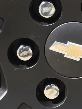

Did my daughters wheels yesterday, gotta say they turned out pretty friggen awsome.
Went from wheel on left to wheel on right.
Took center caps out.
Put painters tape over bowtie and cut around with a exacto knife.
Sprayed plastidip 6 coats.
Went back over same cuts with knife when dry and peeled off tape with dip.
I have a bar stool from harbour freight for my work bench and draped a towel over it
and set wheel on it. Spun it around to paint perfect height six coats on wheels.
Used washers to cover lug nut seats so dip would not get on them.
Also had the custom lug nuts I made so it made them really pop.
Wheels are a little dirty, kids !!
